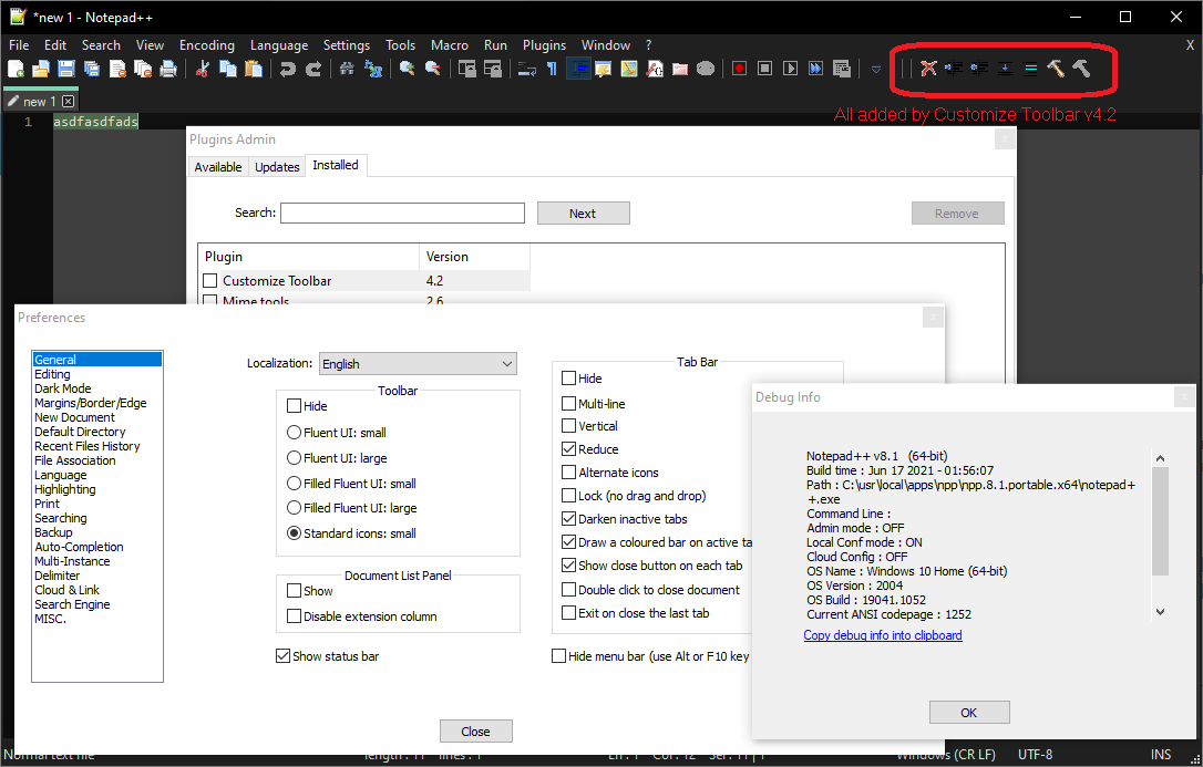

Customize Toolbar 4.2 works with Npp 8.0 & 8.1 if and only if Standard icons: small is selected and dark mode is not enabled in Preferences. Selecting dark mode will force select Fluent icons (UI small). Unselect dark mode, select Standard icons and restart Npp and the toolbar should be (almost) as it was.

Correction. Selecting dark mode will change to Fluent Icons. You are allowed to change back to standard icons even in dark mode, if you so desire.
And once I go back to that, adding buttons with Customize Toolar v4.2 works perfectly fine, even in dark mode.
Notepad++ v8.1 (64-bit) Build time : Jun 17 2021 - 01:56:07 Path : C:\usr\local\apps\npp\npp.8.1.portable.x64\notepad++.exe Command Line : Admin mode : OFF Local Conf mode : ON Cloud Config : OFF OS Name : Windows 10 Home (64-bit) OS Version : 2004 OS Build : 19041.1052 Current ANSI codepage : 1252 Plugins : mimeTools.dll NppConverter.dll NppExport.dll _CustomizeToolbar.dllI would thus correct your original statement
