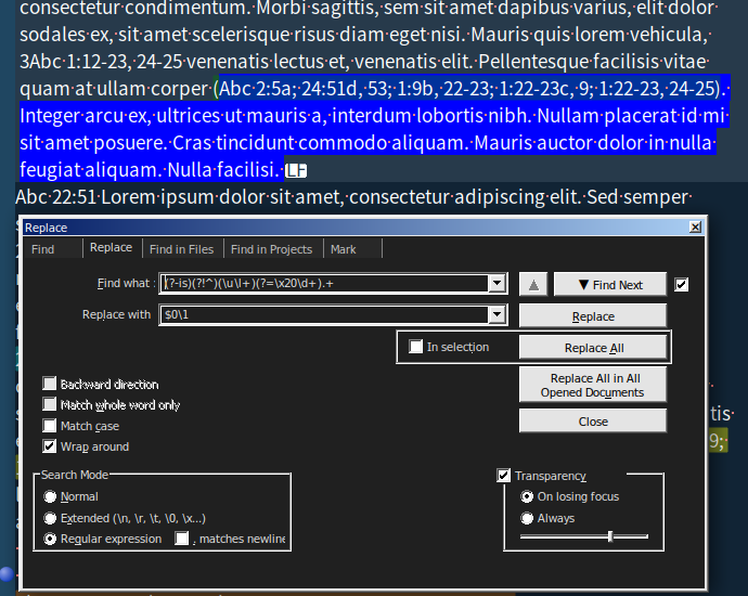

          Yes. Both steps work very well, and it was just as you said. Also, the first regex is indeed not restrictive enough – if there is another word or another sentence after that, this regex captures it all all the way until CR/LF that mark the end of the paragraph.
          Thank you!

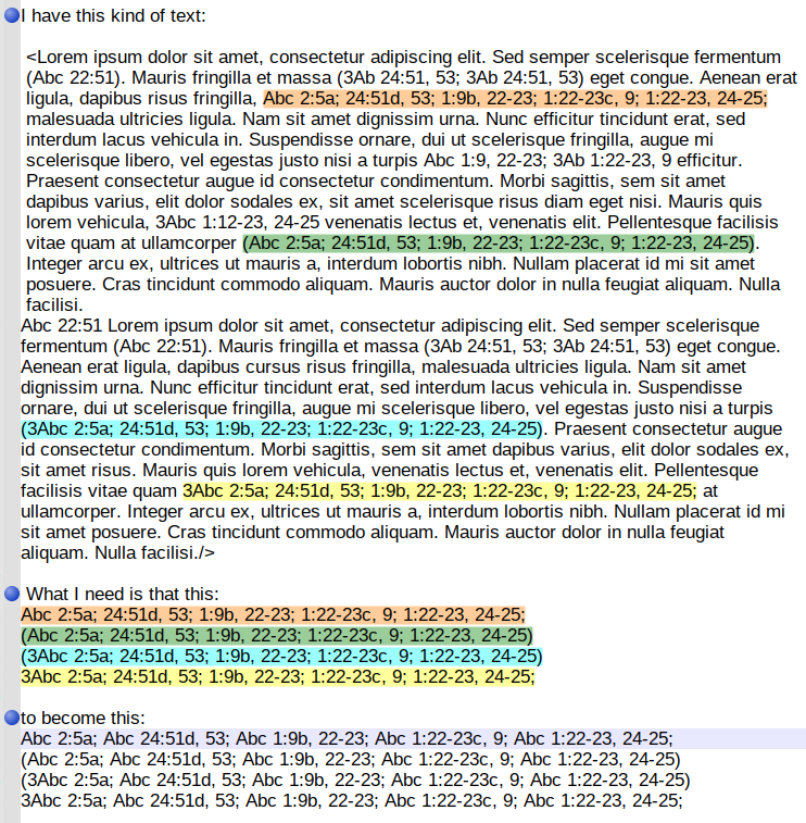

              • As shown in the picture below, what I need is to find this:
                Abc 2:5a; 24:51d, 53; 1:9b, 22-23; 1:22-23c, 9; 1:22-23, 24-25;
                (Abc 2:5a; 24:51d, 53; 1:9b, 22-23; 1:22-23c, 9; 1:22-23, 24-25)
                (3Abc 2:5a; 24:51d, 53; 1:9b, 22-23; 1:22-23c, 9; 1:22-23, 24-25)
                3Abc 2:5a; 24:51d, 53; 1:9b, 22-23; 1:22-23c, 9; 1:22-23, 24-25;
              • and to be replaced with this:
                Abc 2:5a; Abc 24:51d, 53; Abc 1:9b, 22-23; Abc 1:22-23c, 9; Abc 1:22-23, 24-25;
                (Abc 2:5a; Abc 24:51d, 53; Abc 1:9b, 22-23; Abc 1:22-23c, 9; Abc 1:22-23, 24-25)
                (3Abc 2:5a; Abc 24:51d, 53; Abc 1:9b, 22-23; Abc 1:22-23c, 9; Abc 1:22-23, 24-25)
                3Abc 2:5a; Abc 24:51d, 53; Abc 1:9b, 22-23; Abc 1:22-23c, 9; Abc 1:22-23, 24-25;
              • As @guy038 said both steps work very well, and it was just as he said. Also, the first regex is indeed not restrictive enough. As an example, you can see how it goes all the way to the end of the paragraph, as shown in the picture below:
              I hope this time I was much more accurate, and that I do show that I am willing to learn.

                            Let’s go back to the regex explanations ! If we use the ABNF syntax ( Augmented Backus–Naur Form ) ( Refer here ) with the definitions :
                            SP      =  %x20     ;  SPACE char
                            upper   =  %41-5A   ;  A-Z
                            lower   =  %61-7A   ;  a-z
                            digit   =  %30-39   ;  0-9
                            number  =  1*digit  ;  From 1 to any number
                            And being aware of the general notations [X Y ... Z] which means 0*1(X Y ... Z) and (X/Y/...Z) which means X OR Y OR .... OR Z
                            Your expression (3Abc 2:5a; 24:51d, 53; 1:9b, 22-23; 1:22-23c, 9; 1:22-23, 24-25), preceded by a space char, can be expressed as :
                            SP ["("] [number] upper 1*lower 2*( SP number ":" number [lower] [ "-" number [lower] ] [ "," SP number [ "-" number ] ] ( ";" / ")" ) )
                            leading to the search expression of the first regex S/R :
                            (?x-i)                    #  FREE-SPACING mode / NON-INSENSITIVE to case
                            (?<=\x20)                 #  IF PRECEDED with a SPACE char, searches for ...
                            \(?                       #  an OPTIONAL OPENING parenthese followed with ...
                            (\d+)?                    #  an OPTIONAL GROUP 1 containing a NUMBER and ...
                            ( \u\l+ )                 #  an UPPER-CASE letter, followed with some LOWER-CASE letters, stored as GROUP 2, which will be inserted, during REPLACEMENT, between TWO AROBAS chars
                            (                         #  START of GROUP 3
                              \x20 \d+ : \d+ \l?      #    A SPACE char followed with a NUMBER, a COLON char, an other NUMBER and an OPTIONAL LOWER-CASE letter
                              ( - \d+ \l? ) ?         #    An OPTIONAL GROUP 4, containing a DASH, followed with a NUMBER and aN OPTIONAL LOWER-CASE letter
                              (                       #    START of an OPTIONAL GROUP 5, containing :
                                , \x20 \d+ (- \d+)?   #      A COMMA followed with a SPACE char, then a NUMBER followed by an OPTIONAL GROUP 6, containing a DASH char followed with a NUMBER
                              )?                      #    END of the OPTIONAL GROUP 5
                              [;)]                    #    Ending with, either, a SEMMICOLON char OR a CLOSING parenthese
                            ) {2,}                    #  End of GROUP 3, present, at LEAST, TWO times
                            In replacement, we simply rewrite the overall match $0, followed with the group 2, \2, between two @ chars !
                            Now, regarding the second regex S/R, we must :
                            • Add the string, located between two @ chars, after each ;, but the last
                            • And, of course, delete the temporary string @ ••••• @, added by the first S/R, above
                            leading to this search regex :
                            (?x-is)               #  FREE-SPACING mode / NON-INSENSITIVE to case / A DOT matches a SINGLE STANDARD character ONLY
                              ;                   #    Searches for a SEMICOLON char ...
                              (?=                 #    ONLY IF :
                                .+                #      followed with the GREATEST range of chars till ...
                                [;)]              #      a LAST ; character OR a CLOSING parenthese
                                @                 #      followed with an ARROBAS and ...
                                ( \u\l+ )         #      an UPPER-CASE letter and some LOWER-CASE letters, stored as GROUP 1
                                @                 #      and followed by a LAST ARROBAS char
                              )                   #    END of the LOOK-AHEAD assertion
                            |                     #  OR
                              @ .+? @             #    searches an ARROBAS char, followed by the SMALLEST range of STANDARD characters, till ... a SECOND ARROBAS char
                            In replacement :
                            • we use a conditional syntax ?1•••• which means that the searched semicolon will be replaced by itself, followed with a space char \x20 and the contents of group 1 \1 ONLY IF the group 1 exists ( i.e. if the first alternative matched ! )
                            • If the second alternative matches, as group 1 does not exist, the temporary string @•••••@ is then deleted !
