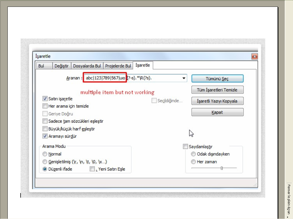

          thanks friends but multiple item not working
          http://prntscr.com/15ae1og

              Hello, @anilin-losar, @alan-kilborn and All,
              Alan, you said :
              And I don’t generally click on external links
              Yes, this is usually a wise precaution ! But I did it, without even thinking ! So, here it is the OP’s image :
              Of course, I have a solution, but I’ll let you be the first to answer !

                  I’d say the OP wants parenthesis around the initial OR’d data, something like (foo|bar|fubar)(?-s).*\R(?s).

                    perfect work , thanks for help guys
