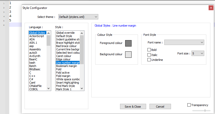

      My line numbers are super tiny (like 6 pt) in 7.9.5 64-bit on Windows 10. They are only 50% of the line height. Is there a way to adjust the size to be readable?

          • jbaker6953J
            jbaker6953

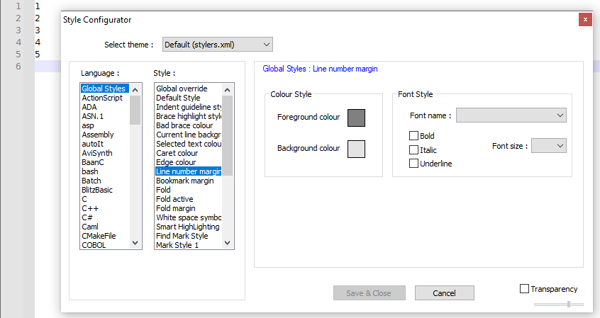

            Thank you. It was set to 8. It seems like changing it to blank made the margin really fat even though it’s set to dynamic.
            alt text
            • jbaker6953J
              jbaker6953
              Turns out that’s what happens if you enable bold line numbers and change the folder margin style. Toggling bold off and on again fixes the margin.
