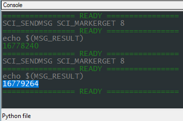

                    Michael Vincent @Anthony Blinco
                    @Anthony-Blinco said in Location navigate plugin + Python editor.markerAdd() colors:
                    I am using 16, i have tried 8 as well and it still apears to override my colors.
                    If you haven’t already, it’s worth giving Markers section of Scintilla docs a read. You define a marker and map it to a type - defined colors for it and then it is applied cumulatively to a line. Marker numbers are just powers of 2 (0-31) to fill in a bitmap to tell which marker values are enabled for each line.
                    For example, using Location Navigate and a Notepad++ bookmark all on the same line, the marker value is:
                    DEC: 16778240
                    BIN: 0000 0001 0000 0000 0000 0100 0000 0000
                    After saving, the value is:
                    DEC: 16779264
                    BIN: 0000 0001 0000 0000 0000 1000 0000 0000
                    Notice, the most significant 1 in the marker value doesn’t change - that’s the Notepad++ bookmark marker value 24. The least significant 1 in both numbers does change - that’s LocNav using 10 for a change marker and 11 for a saved marker. In both instances, the actual “marker” number for the line is the “total” of all markers on that line.
                    Hope this helps.
