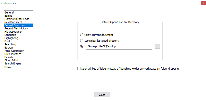

        When I make the change externally and use <GUIConfig name="openSaveDir" value="2" defaultDirPath="%userprofile%\Desktop" />, the next time I open Notepad++, File > New then File > Save As will default to my Desktop, File > Open will default to the Desktop, and Settings > Preferences > Default Directory confirms %userprofile%\Desktop as the default location:
        Further, if you just manually pick your desktop in Settings > Preferences > Default Directory, and then exit Notepad++ and come back in, it will keep your pick, and will still open or save-as from the Desktop; on my system, the setting looks like the following screenshot after closing and re-running Notepad++:

                      If you go to Settings > Preferences > Default Directory, if you click on the ... button, it should pop up your %userprofile%\Desktop directory; if you hit Save, it should come back and the path in that entry should now have expanded to your actual userprofile directory (something like my example c:\Users\Peter\Desktop shown in my screenshot above).
                      If it didn’t, that might mean that for some reason, Notepad++ cannot convert your %userprofile%\Desktop to an actual directory name (maybe there is some strange character, or it’s not properly defined?).

                        Clicking on the ellipsis, the D: drive comes up. In the box I have %userprofile%\Desktop, still D: shows up.
                        If I ctrl-o in Notepad++ and paste %userprofile%\Desktop, it goes to to the desktop. It could indicate that Notepad++ finds no issues with translating the %path% path to a literal path.
                        “f you hit Save, it should come back and the path in that entry should now have expanded to your actual userprofile directory (something like my example c:\Users\Peter\Desktop shown in my screenshot above).”
                        ==> it translated to: D:\OneDrive\OneDrive - Aexis NV\Bureaublad (Bueaublad is Dutch for desktop)
                        After that, hitting Save brings me to the Desktop, which is good ! Also after restart. The icing on the cake would be to be able to use %userprofile%\Desktop, such that if I copy my config.xml file to a remote computer, it would also default to the desktop there :-)
