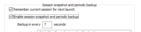

      When I went to close N++ to see what would happen, it gave a message that I would lose the info.
      Yes, unsaved files will be lost if you don’t save them, and if you don’t have the Settings > Preferences > Backup > Enable session snapshot and periodic backup turned on.
      I went ahead and closed it. I reopened N++and all of the tabs with all of the info are there!
      I am not sure what you mean by that. Do you mean that you changed a file, didn’t save it, and yet when you reloaded, the file was there with the changes intact? That usually only happens when you have the snapshot feature enabled (as described above)… but then it wouldn’t have prompted you about losing info.
      What do you think happened?
      I don’t know. I don’t think you’ve described the full sequence of events completely enough, but I could be wrong. But either way, I’m not sure exactly what happened.
      Maybe someone else can chime in, because I’m not sure there’s much more I can do to help you with this situation.

              The “something about … configuration” was my saying Settings > Preferences > Backup, which is supposed to communicate to you that you go to the menu bar, click the Settings menu, then click the Preferences menu option, then in the dialog that shows up, you click on the word Backup. (That’s fairly standard nomenclature in any forums and documentation sets for choosing menu entries in applications on the Windows OS – including some of Microsoft’s own documentation. Settings | Preferences | Backup is another common way of rendering the same action – choosing an entry from a menu.)
              I had previously mentioned that because you implied that it was asking you to save unsaved files, so I was telling you what option controls whether or not it does that. Now you are saying that the opposite is likely true, and that option was already turned on; this implies to me that really, back in your original request, it wasn’t asking you to save because you were closing notepad++ without saving, but that it was really asking you to pick a name for the file that you explicitly told it to save.

                  No. “Backup on save” has nothing to do with the automatic hidden saving of files. That’s why I didn’t bother showing that part of dialog when I was talking about the feature I was describing.
                  At this point, it looks like you’ve got your original problem sorted. Hopefully, my explanations (even if you don’t fully understand them) have started bringing you closer to understanding how file saving works. Good luck.
