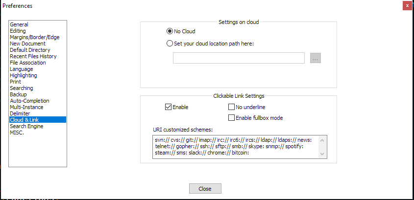

        @PeterJones and here is the screenshot your requested
