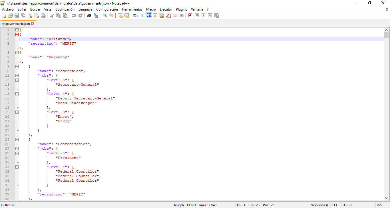

      hi, is there any way to copy only the words in quotes that are in red color in this file?

      Example:
        @Iohiko-Colina
        I don’t see how this can be accomplished without using a scripting plugin.

          1. Make a copy of your file
          2. Replace using regular expression find=.*": replace=nothing
          3. Edit/Line operations/Trim leading and trailing space
          4. find=^[\\]\{\}] replace=nothing
          5. find=\,$ replace=nothing
          6. Edit/Line operations/Remove Empty lines
          This should leave you with a file containing the quoted red text

                    Hello, @iohiko-colina, @ekopalypse, @anthony-blinco, @alan-kilborn and All,
                    No problem with regexes ! It’s the @anthony-blinco’s regex attempt which gave me the idea to simplify the overall process :
                    I assume that your N++ version is, at least, 7.9.1
                    • MARK (?-s)^(?:.+?:)?\h+\K"[^:]+?"(?=,?$)
                    • Tick the Purge for each search and Wrap around options
                    • Un-tick all other box options
                    • Click on the Mark All option ( With your provided JSON sample, it highlights 400 occurrences in red ! )
                    • Click on the Copy Marked Text button
                    • Open a new tab ( Ctrl + N )
                    • Paste the contents of the clipboard ( Ctrl + V )
                    Here we are !
                    Remark : If you prefer to get the different strings without the double-quotes ("), use that second regex :
                    • MARK (?-s)^(.+?:)?\h+"\K[^:]+?(?=",?$)
                    Notes :
                    • The first regex contains an optional non-capturing group (?:.+?:)?. So the overall regex can be decomposed into two regexes :
                      • The regex (?-s)^\h+\K"[^:]+?"(?=,?$) which matches all strings contained in a "level-#": [•••••] block**
                      • The regex (?-s)^.+?:\h+\K"[^:]+?"(?=,?$) which matches the second string of lines beginning with blank chars and a first "xxxxx": string
