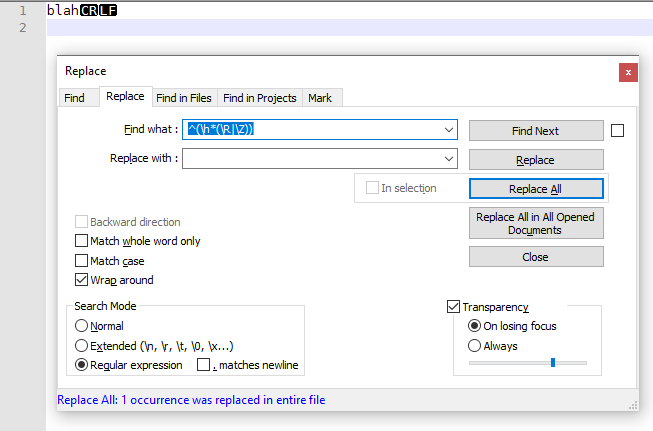

                  I thought I did explain. I mean, I literally said “change the \R in any of those expressions to (\R|\Z)”. How can that be interpreted as “change the R with a Z” – I showed the literal before and after. To expand or rephrase, any place in one of the regular expressions that used to have \R should now have (\R|\Z).
                  If that’s not enough, I will modify @guy038’s bullet points for you.
                  • To delete only empty lines use the regex ^\R+ . For empty lines that might not have a newline because it’s the end of the file, use ^(\R|\Z)+
                  • To delete only blank lines, use the regex ^(\h+\R)+ . For blank lines that might not have a newline because it’s the end of the file, use ^(\h+(\R|\Z))+
                  • To delete, either, empty or blank lines, use the regex ^(\h*\R)+ . For empty or blank lines that might not have a newline because it’s the end of the file, use ^(\h*(\R|\Z))+
                  Note that the second instances (my regular expressions) in each of those bullet points will work identically as @guy038’s for all lines that end in newlines, but will also allow them to work on lines at the end of the file that are missing newlines.

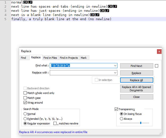

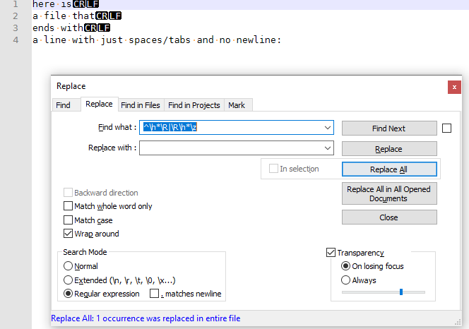

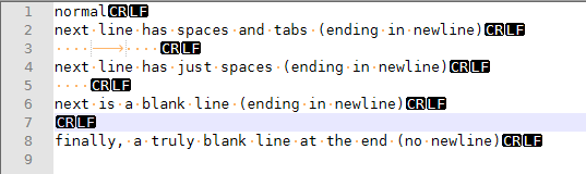

                  However, I will say that if your next-to-last line has text and newline but your last line is empty (no newline), it won’t delete that truly empty line: it will just keep looking like this every time you hit replace:
                  … This is because the character(s) that need to be deleted are actually the previous newline, and aren’t part of the “last” line at all. So for the most generic version, which will work at the end of the file, use ^\h*\R|\R\h*\z.
                  This makes the simplification of using @guy038’s third expression, but without the group wrapper or the + quantifier, because matching one blank line and doing replace all does the same as matching multiple blank lines and doing replace all.
                  The second change is that I am doing the alternate for the full row instead of making an alternate for just the end-of-line section, and allowing a newline followed by 0 or more spaces followed by the end of the file as another match.
                  With that expression:
                  becomes
                  Or if you have a file that ends with spaces and/or tabs, but no newline, it will still work:
                  becomes
                  D.A.G 13D 1 Reply Last reply Reply Quote 0

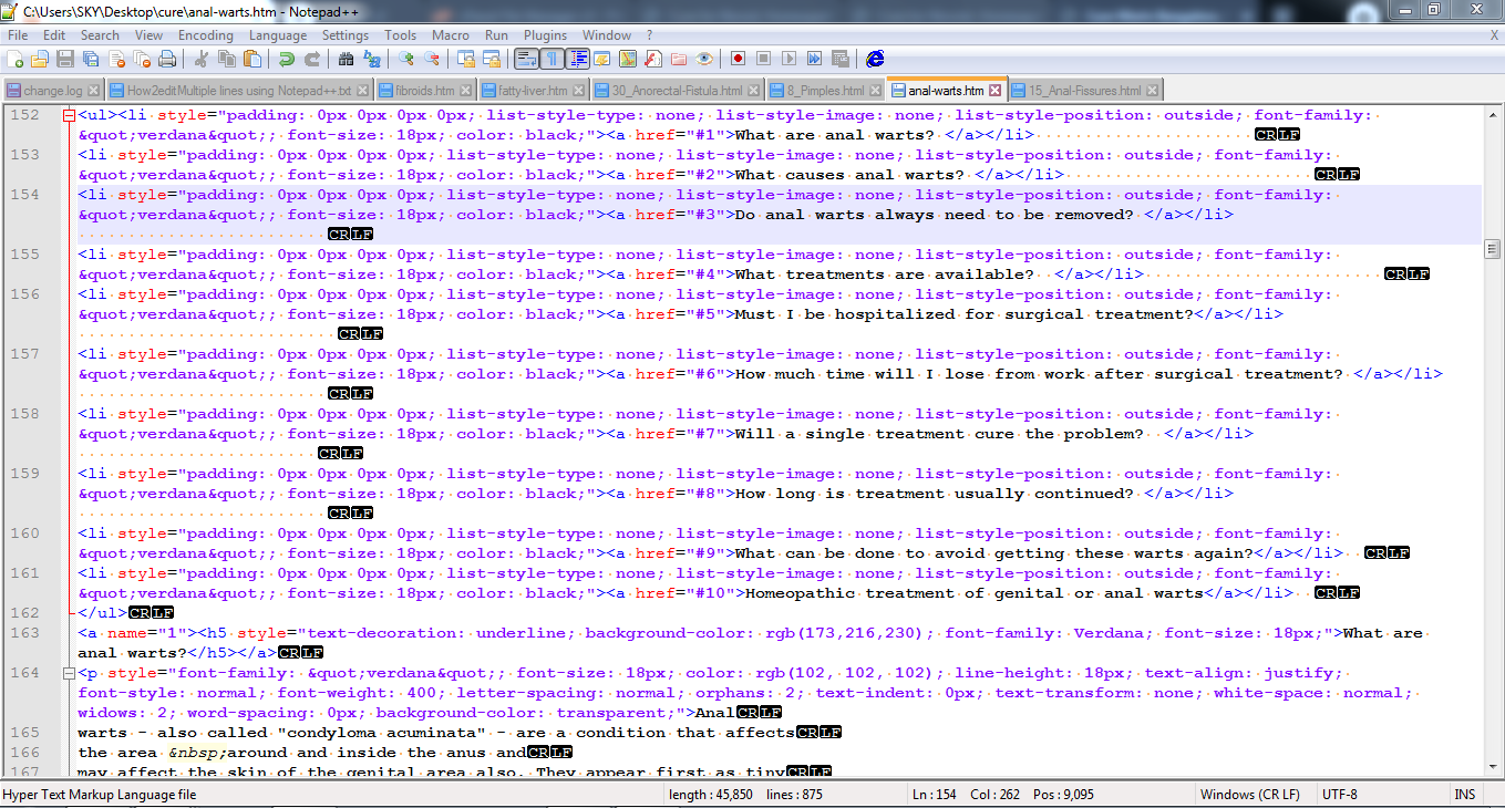

                          @guy038 I tried everything you posted above and while most of those blank lines and empty lines were deleted, I am left with some blank lines with white spaces / blank spaces. Here is a screenshot: Some-white-spaces-blank-spaces-not-deleted.png
                          How to delete those?
                            PeterJones @Ramanand Jhingade
                            @Ramanand-Jhingade ,
                            Those are not blank lines. Those are spaces at the end of the line, that display on the next line of display, thanks to your long lines and having word wrap turned on. You can see this by the line numbering.
                            Find = \h*$, Replace = empty will remove those
                            Ramanand JhingadeR 1 Reply Last reply Reply Quote 1
