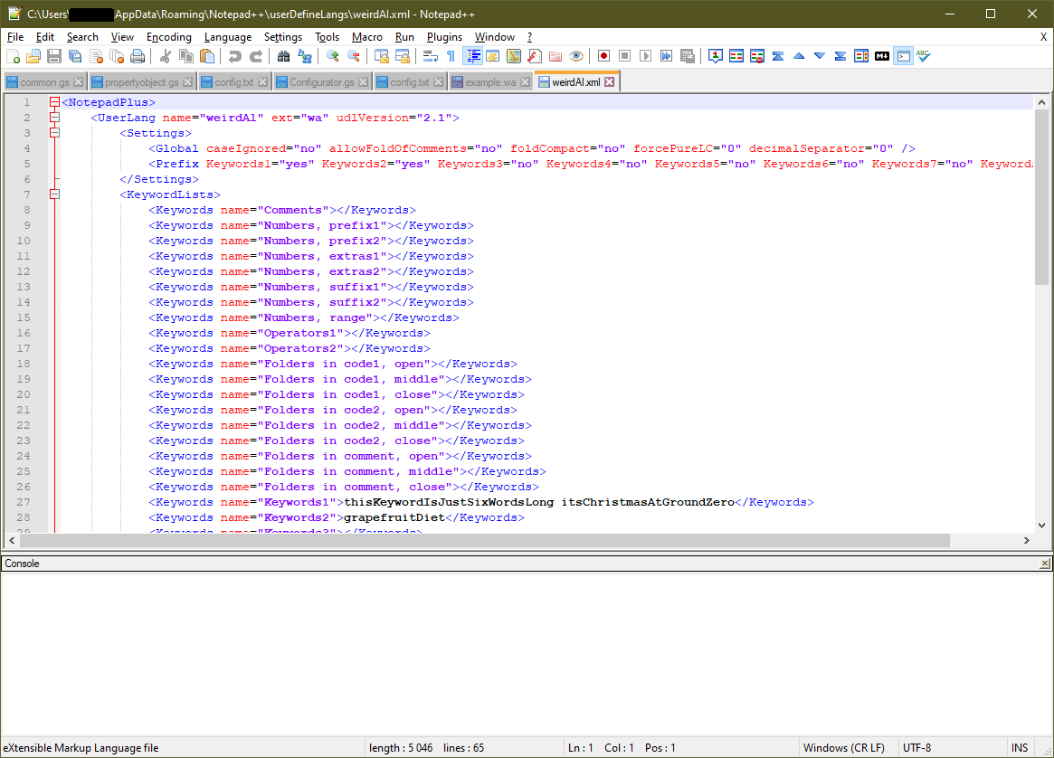

      This one is my UDL file with the relevant parts:
      UDL contents

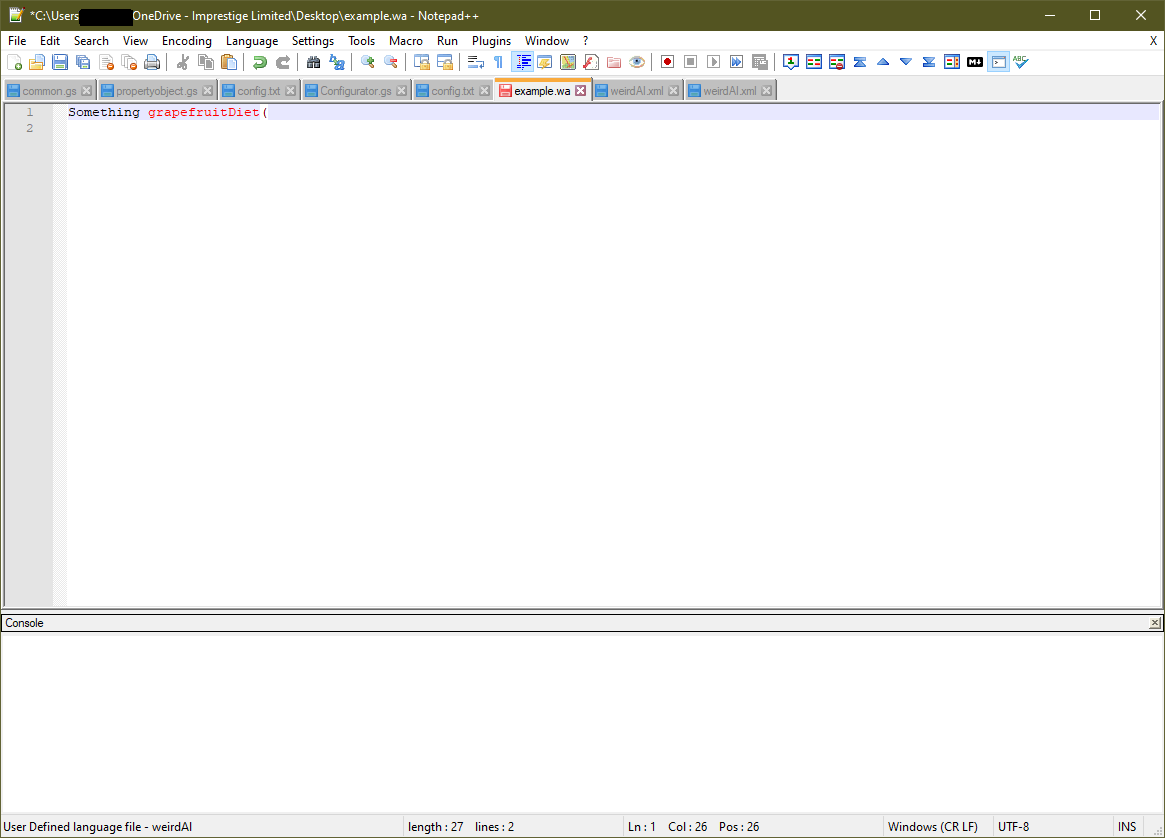

      And this shows the example file with syntax recognized, but autocomplete not working (although it’s turned on and works for other langs):
      Example file
      Can you find any discrepancies here? I’ve exited and restarted Notepad++ after every operation as you also suggested.

        PeterJones @gusztavj
        @gusztavj said in How Notepad++ selects autocomplete?:
        Sorry, everything looks right.

              @PeterJones, this is what I found: autocomplete does not work if the language, as defined in the UDL file, contains keywords with a hyphen in it. The actually weird language for what I wanted to create an autocomplete file includes lot of keywords of this kind, such as “category-keyword”. For these, no autocomplete tip will pop up. Even worse, the values of these so-called tags are followed by a space, so a line of the file looks like this:
              category-keyword “value”
              or
              position 0, 1, 0
              Now it would be okay to type a ( character after a tag name to display the hint, but the hyphen makes this language incompatible with the auto-complete logic. :(
