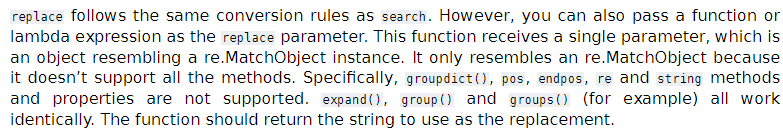

                      Here is my exact replaceList.py with your data:
                      # encoding=utf-8
                      """in response to https://community.notepad-plus-plus.org/topic/21225/
                      Written by @PeterJones
                      Searches for the value of keywordText multiple times, and replaces it with the next element of replacementList
                      from Npp import *
                      keywordText = 'TYPEE'
                      replacementList = [ 'CANADA', 'MEXICO', 'COSTA RICA' ]
                      counter = -1
                      def nextReplacement(m):
                          global counter
                          counter += 1
                          return replacementList[counter] if counter < len(replacementList) else m.group(0)
                      editor.beginUndoAction()
                      editor.replace(keywordText, nextReplacement)
                      editor.endUndoAction()

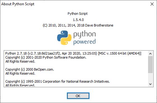

                      You might want to go to Plugins > PythonScript > Show Console and look for errors. (You can right click in the console window, click Clear, then run the script again on your data file. If anything is printed in the console, it’s an error message.) The error message will likely indicate where you have a typo or syntax error in the script that was introduced when you put in your new keywordText and replacementList. If you need help with that, copy/paste the errors you see into the forum (as well as your modified copy of replaceList.py)
