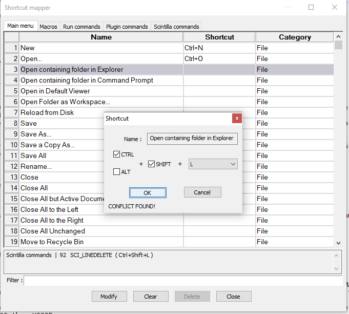

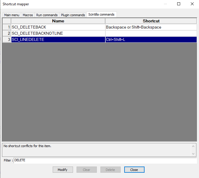

      PeterJones @Doc Trins O'Grace
      @Doc-Trins-O-Grace said in Simple is as Simple Does:
      I have tried using the search phrases “delete line” and “remove line” and “key definitions” and “define key” etc. etc. etc.
      I am surprised you weren’t able to find them; searching here should come up with those features. For example, searching for “delete line” by most-recent first came up with a post named “How to add a “Delete line” command to the context menu” as the second result. That post would have given you the same answer as I will share below, plus explain how to add that command to the right-click context menu, to boot.
      Keyboard shortcuts (what you called “key definitions” or “define key”) are handled in the Shortcut Mapper, accessed from the Settings menu. The normal “editor” commands (copy, paste, delete, …) are in the “Scintilla commands” tab of the shortcut mapper. You can use the filter: DELETE to just look for ones with “DELETE” in their name:
      The command you are looking for is SCI_LINEDELETE, which I have mapped to Ctrl+Shift+L (but I think that’s a personal change; it might be unmapped by default edit: that other thread shows the same shortcut, so maybe that’s default).
      PS: for future reference, it is always better to give meaningful names to forum discussion topics/threads/discussions, in this Notepad++ Community Forum or any other forum I’ve visited since “the internet” was nearly all plaintext BBS’s in the late 80s and early 90s. A name like “Simple is as Simple Does” might sound like a clever Forrest Gump or similar reference to you, but it doesn’t tell people reading this discussion what your question is actually about. A better name would have been something like Is there a Line Delete function or keystroke in Notepad++. With that bad name, and your first sentence starting “I have tried using the search phrases…”, I was getting ready to answer with generic search-and-replace help. It wasn’t until my second or third reading of your post that I figured out you were really trying to find or change the keyboard shortcut for a specific editing action in the Notepad++ editor.
      Doc Trins O'GraceD 1 Reply Last reply Reply Quote 2

                Alan Kilborn @Doc Trins O'Grace
                @Doc-Trins-O-Grace
                take umbrage
                I certainly was not meaning to offend in any way.
                I apologize for asking questions whose answers seem obvious to you
                I don’t know that you did this…
                Perhaps I could have provided a more direct answer, so let me try again:
                Press Ctrl+Shift+L, because as shown in the Shortcut Mapper, this is the default assigned keycombo for SCI_LINEDELETE:
                Imgur
                But to be honest, I had to look this up. Why? Because as an old programmer myself, I came to Notepad++ with 25 years or so of experience with other text editors, and I got use to their keymapping, which in general was very different from Notepad++'s.
                But it is all good because Notepad++ lets me configure what I want.
                To me, for reasons I can’t recall, Ctrl+y has always been delete-line.
                And Ctrl+t has been delete-from-caret-to-end-of-line.
                Etc. etc.
                And this may be something you “need” as well.
                I picture you maybe as a vi guy that is keycombo everything, and when you try a keycombo from vi and it doesn’t work in Notepad++, you get that frustrated feeling.
                Well, if that’s the case (long shot maybe), I understand it, but Notepad++ has a different paradigm than vi and would take some getting used to.
                But I still maintain that you shouldn’t feel “frustrated” when you don’t instantly know how to accomplish things with a different text editor than one you’re used to – regarding keycombos at least. Functionality wise, it’s mostly “all there”, you just have to become familiar.
                        @Doc-Trins-O-Grace ,
                        As @Alan-Kilborn said, there is no built-in method. He linked to one discussion of workarounds, and gave the results of those investigations.
                        Personally, if I’m curious if a key combination has been assigned to something, I go into Shortcut Mapper and try to assign it to something that doesn’t already have a shortcut – the third item (“Open containing folder in Explorer”) on the Main Menu page of shortcut mapper has no shortcut, so that’s the one I usually use. Try to assign it the shortcut in question (like Ctrl+Shift+L), and it will tell you if there’s a CONFLICT FOUND, and even show you where:
                        … which tells me that Ctrl+Shift+L is already assigned on the Scintilla Commands tab, row 92, entry SCI_LINEDELETE.
                        You can then cancel out of the shortcut modifier, to avoid setting that conflicting shortcut.
                        • Doc Trins O'GraceD
