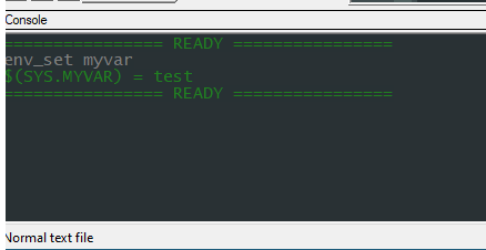

        NppExec variables I don’t think so. Using NppExec to set system environment variables - I don’t think so either. Running Notepad++ inherits the default environment. If you open a Command Prompt or Powershell prompt, set a special environment variable (myvar) and then open Notepad++ from that command line, you’ll see myvar in NppExec:

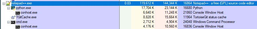

        However, that’s because NppExec is deriving its environment from Notepad++. If you then set environment variables in NppExec, they won’t be reflected back in that original Command Prompt you launched Notepad++ from. Nor will PythonScript - which is deriving its environment from Notepad++ - see any NppExec set environment variables. Maybe this screenshot from Process Explorer helps explain:
        The cmd.exe under Notepad++ is me launching a CMD.exe process in NppExec console to have it “show up” in Process Explorer. You can see the hierarchy. Environment variable inheritance flows down, not up.
        Note, this is my “diagnosis” - this may not be fact, but is backed by my experimentation. Anyone who knows for sure feel free to correct me.
