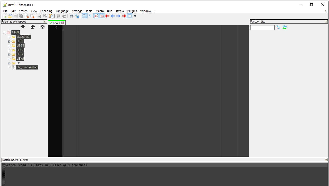

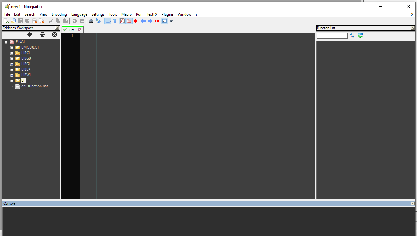

 So when i search it seems to reset the colour settings for the panels in notepad++. This only happens the first time i search. If i close and open the panels after that it doesn’t happen.
 BEFORE
 AFTER
 I’ve never seen that happen. Could you please share your ? menu’s Debug Info, as well as what theme you are currently using? The first will show us exact version and what plugins you have installed (both of which might affect the behavior); the second might show that it happens because your theme is out of date, and doesn’t have all the style settings that it needs.

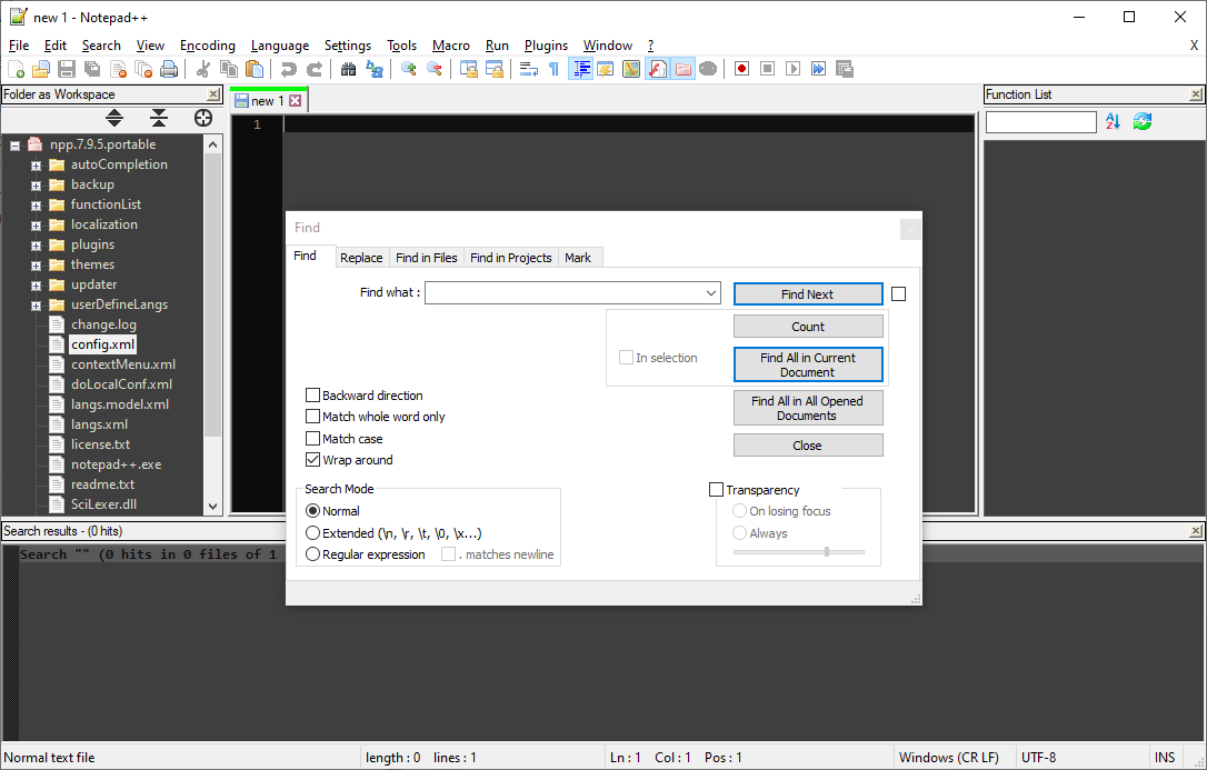

 For files too big to be embedded, the best you can do is link to a filesharing site, and hope that the IT department of the person who knows how to help you doesn’t block that site. (Mine does block, but I’m home right now, so I was able to grab it)I didn’t install all your plugins. I tried with a fresh Notepad++ v7.9.5-32bit portable, I pasted in your theme as ModifiedZenburn.xml, and selected that theme. Then I restarted Notepad++, ran Find > [blank] > All In Current Document, and it popped open the search results, and didn’t mess up the colors.  Notepad++ v7.9.5 (32-bit) Build time : Mar 21 2021 - 02:09:07 Path : C:\usr\local\apps\npp\npp.7.9.5.portable\notepad++.exe Admin mode : OFF Local Conf mode : ON OS Name : Windows 10 Home (64-bit) OS Version : 2004 OS Build : 19041.985 Current ANSI codepage : 1252 Plugins : mimeTools.dll NppConverter.dll NppExport.dllWith that, I think it’s probably one of your plugins. You can run with the -noPluginoption to disable all plugins and see if the problem goes away, which would prove it’s a plugin. To narrow it down to a specific plugin, you could go intoC:\Program Files (x86)\Notepad++\Plugins\and rename the sub-folders one at a time and restart Notepad++ each time (thus disabling each plugin in turn), until the problem goes away; whichever was the last plugin disabled was the culprit.

 One thing i didn’t mention is that you have to use one of the Find ALL buttons. It doesn’t happen whith Find Next

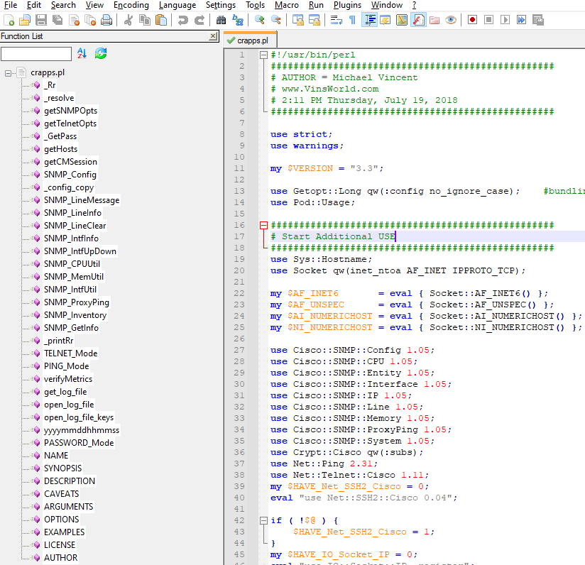

 @Anthony-Blinco said in Search resets the colour setting for panels: I thinnk it’s something like that. I can live with it. Running with -noPlugin and the default style, when I open Windows Explorer, it still does the weird coloring thing in Function List for me:  So at least in my case, it doesn’t seem to be plugin or theme related. Perhaps a Windows setting conflicting with Notepad++. This is why I never bothered to address it - switching away from Function List then back to it makes the anomaly go away. Cheers.
