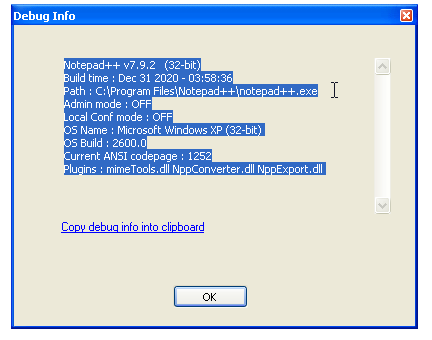

            I just found instructions for setting up a Windows XP virtual machine, so I just set one up and installed v7.5.1 then installed v7.9.2 overtop of that. When I run v7.9.2 on Windows XP 32bit, I did not get the error message you mentioned.
            Here is my ?-menu’s Debug Info
            You might want to compare that to your own. (Maybe you have the XP service packs; the virtual machine I downloaded has those service packs yet, and I cannot get its ancient browser to navigate to a site to download another browser or the service packs. I’ve given up on that, sorry…)

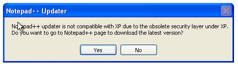

            When I try to run the ?-menu’s Update Notepad++, I get a message, but it’s nothing like the gup.exe error you showed.
            So even with as close to your setup as I could get, I cannot replicate your problem.
