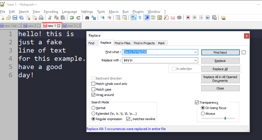

              PeterJones mention a good way and here is another way using regex:
              search for :(\w+\.?!?\s){2}
              replace with : $&\r\n
              search mode : regular expression
              change 2 to the X amount of characters you want
