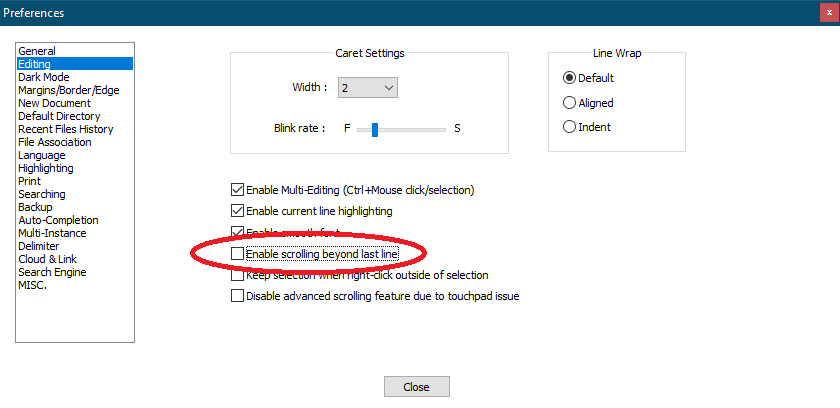

        Michael Vincent @Bill Kristy
        @Bill-Kristy
        Do you have the following Settings => Preferences… enabled (checked):
        Try unchecking it like my setup.
        Bill KristyB 1 Reply Last reply Reply Quote 2

          • Bill KristyB
            Bill Kristy @Michael Vincent
            @Michael-Vincent That solved it, thank you a billion times!!!
