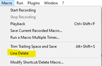

          Use the Macro menu to save your macro, thusly:
          After doing that your Macro menu will contain it:
          It is the appearing on the Macro menu that allows the contextMenu.xml entry that I showed before to work.

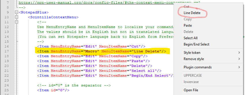

              Well, again maybe my original glossed over some details, when talking to a “noob”.
              You can’t just add it, like at the bottom.
              You have to insert it, at a valid place.
              Try inserting it around Copy or Paste since it is a similar function.
              Here’s where I did it (in yellow) and you can see it worked for me (circled in red):

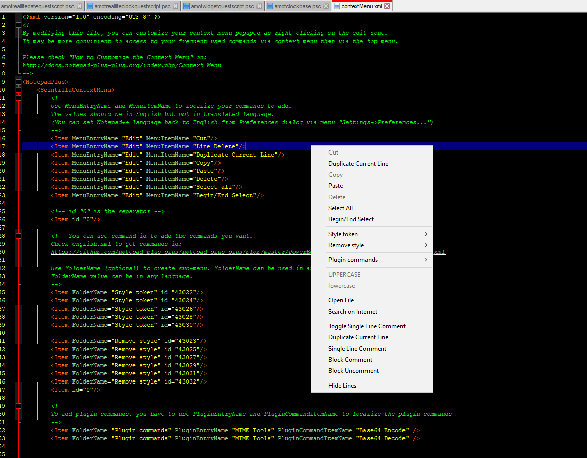

                Are you sure there isn’t an addition step I need to do for macros to appear in the context menu? As you can see, I added “Duplicate Current Line”, but the “Line Delete” isn’t showing up.
                • R JR
                  R J
                  OK I just noticed you used “Macro” for the MenuEntryName instead of “Edit”. This worked. I wish this was explained somewhere.
