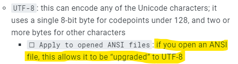

      Even the USER MANUAL doesn’t really tell the tale:
      BTW, this is great discussion because I’m currently doing an exploration of “encoding and N++”; not encoding itself, but just how N++ deals with it…
        @Alan-Kilborn said in UTF-8 encoding for new documents - This a bug, an oversight or intended behavior?:
        Could you clarify that, or provide a phrasing that you think would work better in the usermanual? Because I believe Notepad++ behaves exactly as described in that highlighted section
        1. Create two ANSI files: one zero-byte (ansi0.txt) and one four-byte with the text ANSI (ansi4.txt). Close both.
        2. Uncheck that checkbox. Open ansi0.txt and ansi4.txt. Both are opened as ANSI, since they have no UTF-8-specific codepoints. Close both.
        3. Check that checkbox. Open ansi0.txt and ansi4.txt. Both are opened as UTF-8. Close both.
        So, while you did find the section of source-code that deals with 0-byte files and that option, it also applies that option to non-0-byte files

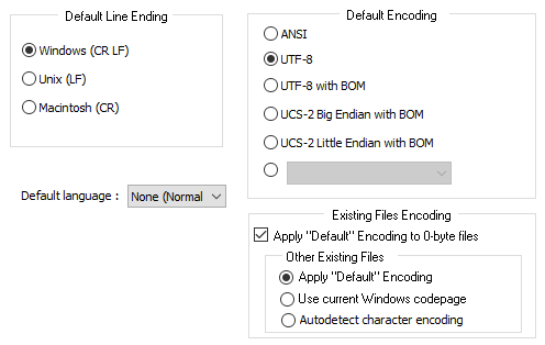

                Interesting idea. That works for someone who understands basic encoding ideas (like you). But a newbie wouldn’t be expected to know what a “7bit file” is.
                Regarding UI: I might be tempted to move the … MISC > Autodetect character encoding option to the New Document page, and rename that page Encodings / Line Endings or something – maybe File Interpretation ? I don’t know what’s the best phrasing.
                I don’t know. UI Design is hard.

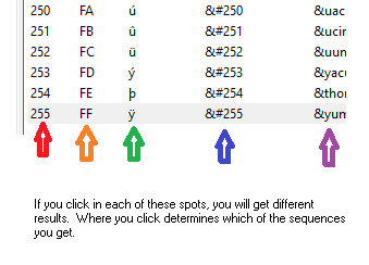

                        BTW, I tried to create this file within N++ by making sure my status bar said “ANSI” and then double-clicking the 255 line in the Character Panel to insert the character. Unexpectedly (to me at least) what I actually achieved was two F characters inserted into my file, instead of one byte with value 255.
                          Where you click in that panel determines what you get. If you click on FF, you get FF. If you click on ÿ, you get ÿ. If you click on ÿ, you get ÿ
                            @PeterJones said in UTF-8 encoding for new documents - This a bug, an oversight or intended behavior?:
                            Ha. Amazing. I never knew that.
                            Of course, I have never used this panel before today.
                            I have very close to zero use for “ANSI”; that’s probably the reason.
                            Thanks for the good info!
                              Hello, @alan-kilborn, @imspecial, @ekopalypse, @peterjones and All,
                              Alan, I think that, in your post, the term 7 Bit is not appropriate as ANSI encoded files use a 1-byte encoding, i.e. a 8-bit encoding !
                              Eventually, it would be better to change the phrase Apply to opened ANSI files in section Settings > Preferences... > New Document > Encoding with :
                              • Encode, in UTF-8, any ANSI file, with ASCII characters only (NO char > \x7F)
                              Best Regards

                                  Hello , @alan-kilborn,
                                  OK, I understand what you mean and, actually, my formulation (NO char > \x7F) and yours 7 bit files do mean the same thing, namely that the eighth bit is not used ( so = 0 ) in existing ANSI files which are automaticaly encoded in UTF-8 on opening, if the squared box is ticked !
                                  Now, I think that my formulation, of my previous post, should be improved as :
                                  • Encode, in UTF-8, any opened ANSI file, with ASCII characters only (NO char > \x7F)
