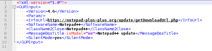

        It works for me:
        Using the <installdir>\updater\gup.xml that ships with notepad++ (the last XML I had in my recent files):
        <?xml version="1.0"?> <GUPInput>     <Version>4.6</Version>     <Param/>     <InfoUrl>https://notepad-plus-plus.org/update/getDownloadUrl.php</InfoUrl>     <SoftwareName>Notepad++</SoftwareName>     <ClassName2Close>Notepad++</ClassName2Close>     <MessageBoxTitle isModal="no">Notepad++ update</MessageBoxTitle>     <SilentMode>yes</SilentMode> </GUPInput>
        BEFORE:
        Plugins > XML Tools > Pretty Print:
        <GUPInput>
            <Param/>
        </GUPInput>
        ? > Debug Info
        Notepad++ v7.9.5   (64-bit)
        Build time : Mar 21 2021 - 02:13:17
        Path : C:\usr\local\apps\notepad++\notepad++.exe
        Local Conf mode : ON
        OS Version : 1903
        OS Build : 18362.1256
        Plugins : ComparePlugin.dll ExtSettings.dll HexEditor.dll LuaScript.dll MarkdownViewerPlusPlus.dll mimeTools.dll NppConsole.dll NppConverter.dll NppEditorConfig.dll NppExec.dll NppExport.dll NppFTP.dll NppUISpy.dll PreviewHTML.dll PythonScript.dll QuickText.dll TagLEET.dll XMLTools.dll
        Plugins > XML Tools > About:
        Notice I provided enough information that you could replicate versions of both NPP and the plugin (the Debug Info lists all installed plugins; maybe something else was interfering in yours). That information is useful to provide

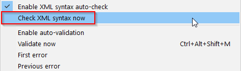

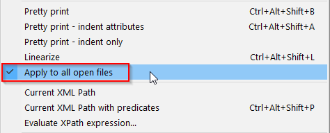

                            (Un-)Fortunately not, maybe that was the issue this thread is about. The XML Tools plugin has the ability to apply pretty-printing on all files currently opened via a menu option:
                            @PeterJones said in XML Tools Plugin - Can't get Pretty Print feature to work:
                            find unclosed tags and close them
                            It really doesn’t work that way.
                            Of course, XML Tools plugin does not fix unclosed tags but it is able to find them by its Check XML syntax now feature:
                            As you can see in the screenshot above it is also able to syntax-check an XML file while a user is editing it.
                            The Validate now and Enable auto-validation features do not check the syntax but validate the XML document against an XSD schema file.
