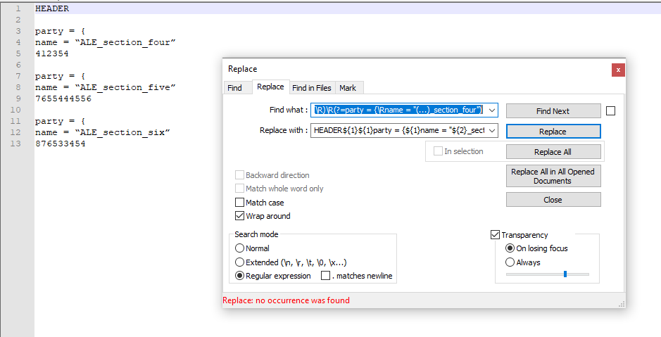

@Alan-Kilborn Is not finding it
You may need to adjust your double-quote characters in the “find” and “replace” expression I gave.
If you look closely at your screenshot data, you’ll see that yours are “slanted” and I used “straight” in my expressions. They are not interchangeable – welcome to a unicode world.
I did what I did because you pasted data into this site without preserving its format, so I made my “best guess” at what you had.
Or, it could be something else wrong.
But…I’d start there. -
@Vincent-Perez said in Adding text with variable on several files:
“ALE_section_one”
You were right! thank you very much, you have saved me a lot of hours of boring copy paste :-)
