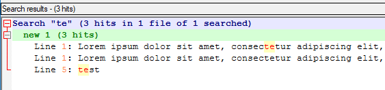

        So, for clarity, you are talking about the data that appears in the Search results area, and its colorings; example:
        So you like the blue-on-blue “Search” line, the greenish filename line (here the file is new 1), the nice red-on-yellow of the search hits, etc.

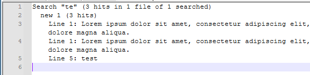

        Well, sad to say, these are just visual effects within Notepad++. And with Notepad++ being a “text editor”, the only thing that is copied when you copy, is…text.
        That’s why if you copy and paste the data I show, you’ll get:

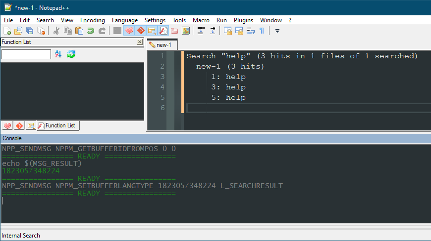

                Thought maybe I could force a buffer to use the internal Search Result language defined in the lang.xml file by using NppExec as such:
                The document type (notice bottom left status bar) now reflects “Internal Search” instead of “Normal text file” (my default), but no lexing. Perhaps I’m missing something?
                  Ekopalypse @Michael Vincent
                  @Michael-Vincent
                  I haven’t checked the source code, but I assume that no styles are set, probably because npp doesn’t expect the lexer to be assigned in the default views.
