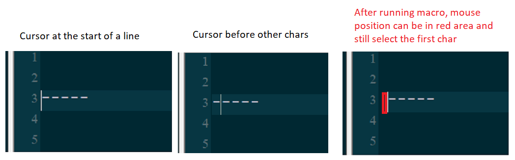

      The reason for using this gap is related to positioning the cursor at the beginning of a line and selecting one or more characters from the beginning of a line using a mouse.
      By default in np++, there are less pixels to the left of the first character of a line than other characters that can be used for positioning the cursor and selecting text.

      But it mentions adjusting the margin which behaves differently. I believe that left-clicking the margin selects the line text, whereas left-clicking the gutter positions the cursor at the beginning of the line.

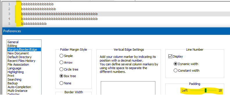

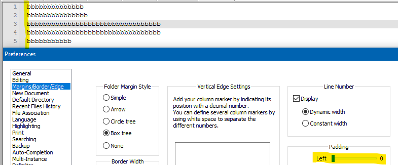

              There will be a new setting in the next release of Notepad++, presumed to be 7.9.6 that probably helps with the OP’s need.
              Here’s an example of the existing way it is, and the new setting with Left Padding set to zero:
              Contrast that with a non-zero setting for it:
              And yes, it does help make mouse-selecting a column 1 character a bit easier (the only real practical use I see for it).
