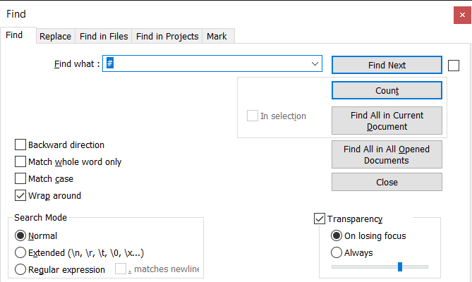

      Hello all, hope you doing well, I need help with something. So I searched for a letter, and the result is almost 4000 found. I want to delete all lines which include “#” how do I gonna do that? Is there anything to do that instantly?_C__Users_ymete_Desktop_cheat.db - Notepad++ 4_18_2021 7_20_47 PM.png
        Hello, @meтe-ялчынкая and All,
        Very easy with regular expressions or bookmarks !
        • A) With bookmarks :
          • SEARCH #
          • Untick all the options
          • Tick the Bookmark line option
          • Tick the Wrap around option
          • Then, run the menu option Search > Bookmark > Remove Bookmarked Lines
        • B) With regular expressions ( faster ! )
          • SEARCH (?-s)^.*#.*\R
          • REPLACE Leave EMPTY
        The search regex searches, from beginning of line ( ^ ) for any range of standard characters, even none ( .* ), followed with a # char, and again, with any range of standard characters, even none( .* ), till the EOL characters of current line ( \R )
