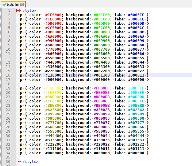

                    I decided to take a look, because it interested me, and I needed a mental distraction.
                    @Alan-Kilborn said,
                    Well, I was thinking that the OP would want to have many possible of these #xxxxxxx on screen at once, all representing their color. An indicator must be dedicated and can only have one color at a time, for all occurrences of that indicator on screen. So this doesn’t seem all that viable if that is what truly is wanted/needed.
                    My thought was, because of the way that @Ekopalypse designed the indicators, there might not be a limit, because he’s using the same indicator for all the colors in the various regex for a give lexer.
                    And in my experiments, I can show at least 90 colors and still hadn’t hit a limit.
                    I think it works because with the SC_INDICFLAG_VALUEFORE flag and the INDICVALUE.BIT being set in the RGB.
                    Quoting from Scintilla docs (emphasis added):
                    There is currently one flag defined, SC_INDICFLAG_VALUEFORE: when this flag is set the colour used by the indicator is not from the indicator’s fore setting but instead from the value of the indicator at that point in the file. This allows many colours to be displayed for a single indicator. The value is an RGB integer colour that has been ored with SC_INDICVALUEBIT(0x1000000) when calling SCI_SETINDICATORVALUE
                    I made a gist of the modified EnhanceAnyLexer-HtmlColor, showing how I did it. It’s just a proof-of-concept; it would need cleanup before being used regularly. Also, be forewarned: it slows Notepad++ way down, especially if there are a lot of matches. I would not use this method in a real editing situation; it is just proof-of-concept.
                    My modifications add a special “regex” notation of “PCJ:CSSCOLOR” which will change the coloring rules: if you use that “regex”, it will actually match r’#[[:xdigit:]]{6}’ and grab the color from the RGB value, and use that during the paint_it() call.

                          If you are willing to toggle the colors on/off on-demand, still using PythonScript, see my new gist for ColorizeHtmlCssColors.py.
                          This one is practical.
