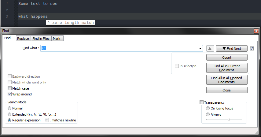

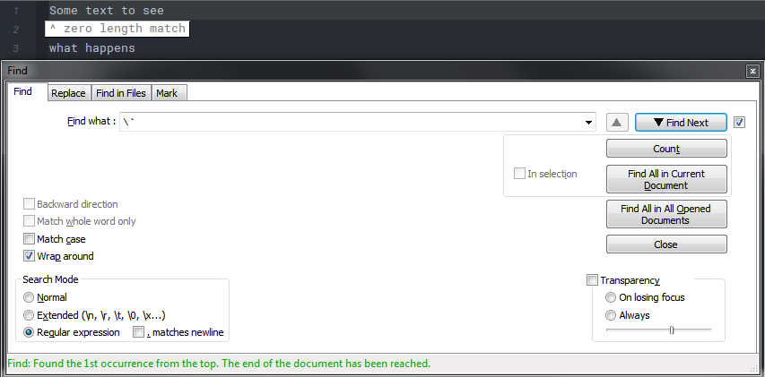

      Not sure if this is a bug in the regex engine, or an inaccuracy of the online user manual, or just me misunderstanding something as usual…
      The manual states that \z or \` matches the end of the matching string, which I believe also means they can match the end of the file. \z works perfectly for me for that purpose, but \` seems to not match anything for me. Comments/corrections/criticisms? (I don’t have to, nor have any burning desire to, use \` , but just pointing this seeming discrepancy out, since it’s in the manual.)
        There is indeed an issue, \' matches the end buffer and the other the start of buffer
