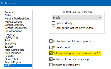

              Could you, please, provide more detailed scenario to reproduce the issue?
              I’ve just tried in Notepad++ 7.9.1 portable and couldn’t do that.
              What I did:
              • Turn off Preferences > Default Directory > Use new style dialog
              • Turn off Preferences > MISC. > Set Save dialog file extension filter to .*
              • File > New
              • File > Rename > “new.123”
              • Type some text to the document
              • File > Save As
              • .txt is not added, type is Normal text file

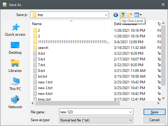

                Steps with 7.9.1 to make it do what the OP of this thread wants to have happen:
                • Extract 7.9.1 portable and run it
                • type some chars to modify the tab entitled new 1
                • Ctrl+s
                • type test.123 in the File name box
                • press Enter
                Result is: test.123.txt <— .txt is added
                mere-humanM 1 Reply Last reply Reply Quote 3

                    @Alan-Kilborn said in 7.9.5 Not Appending extension to files with period in name:
                    Oh, I see! Thank you.
                    Then, as for me, it looks like another regression in the new Save As dialog.
                    File dialogs were changed changed in 7.9.3 in scope of #9374.
                    So I’d just fix it to behave like in 7.9.1 (append file extension for the mentioned case).

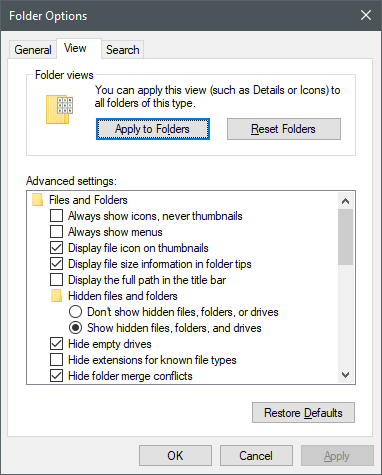

                          @Brian-D Do you have this Hide extensions option ON by any chance?
