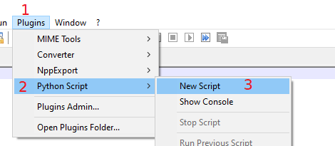

            That post you linked was pretty explicit about the steps necessary. But if screen captures are needed, I will intersperse them between the quoted version of the plain text instructions from that post:

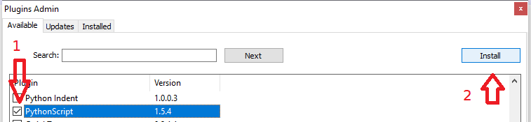

            • Use Plugins admin to install the PythonScript plugin
            • Menu to Plugins > Python Script > New Script

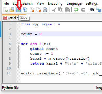

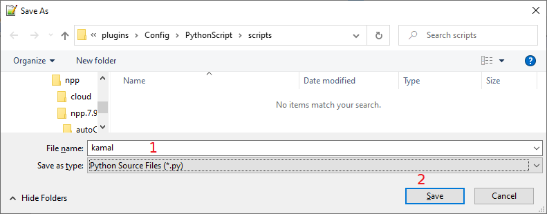

            • Provide a (file) name for the script; you don’t need to specify an extension – .py will be added automatically
            • Press the Save button to close out the Save As dialog box.

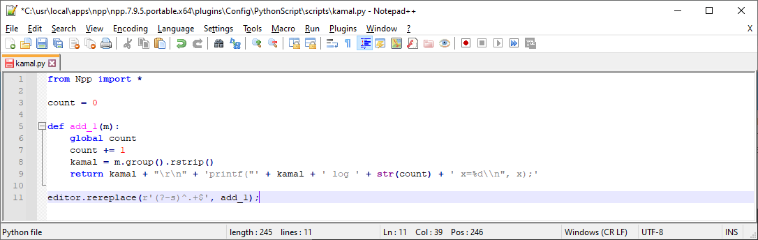

            • At this point your script file will be showing and is empty; copying and pasting one of the scripts from above seems like a fine idea :-)
            after pasting, it will look like:
            Please note: your post lost the leading spaces when you quoted the script. In Python, indentation carries meaning, so make sure you actually copy/paste the text from my post, not from yours that has lost the spaces. If you disregard this advice, it will not work. It should look like the screenshot above.

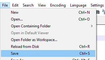

            • Save the file

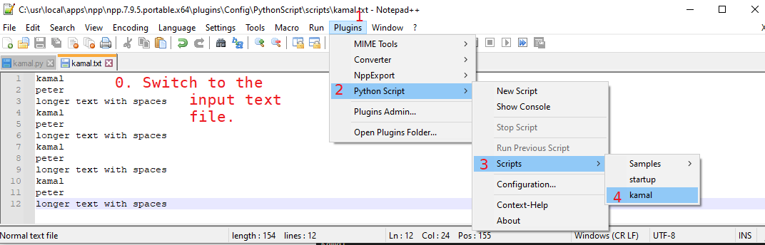

            • To execute your script, menu to Plugins > Python Script >Scripts > (pick the name of your script)

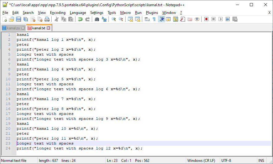

            And after running that, you will have a file that looks like:
            Those screenshots are just a direct translation of the text of Alan’s instructions into the application.
