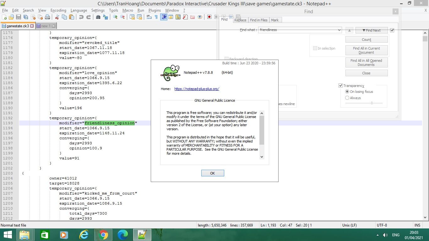

            P/S: I’m using Notepad ++ v7.8.8, maybe need to turn on/off some functions to make the search work, but I dont know which functions. So if needed and anyone know, pls tell me (or tell me any good workingNotepad++ version), tks so much.
            I attach screen picture here
              Hi, @trần-hoàng-long and All,
              OK, I’ve got your file, that I simply changed as a .txt file. Nice !
              Now, it’s still unclear ! In your first post, you said :
              … so I want to use Replace function to delete all “love opinion”
              And in your second post, you said :
              I want to delete all “temporary_opinion” which are not “love_opinion” or “**friendliness_opinion**” in those paragraphs.
              Once I know what is exactly needed, with the true file, it should be easy to found out a solution;-))
