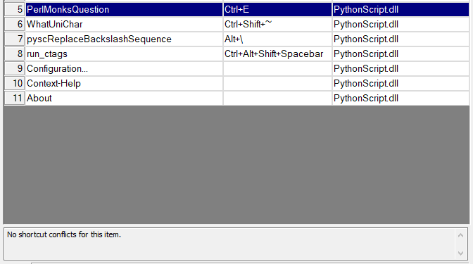

          In the shortcut mapper view, it originally said “No shortcut conflicts for this item”:

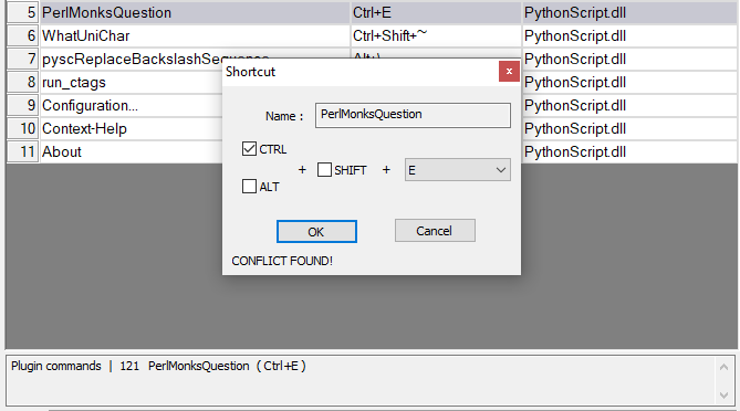

          But if I Modify that line’s shortcut, it claims it is conflicting with itself:
          If I Clear it and modify it again to re-add the Ctrl+E, it finds no conflict.
          If I clear it there, and assign Ctrl+E to some other Plugin Command entry, the same thing happens (it claims CONFLICT on that keystroke if I Modify that same entry).
          More experiments show: It’s caused when I filter the view – and then, only when the number in the far-left column changes. If I go to ShortcutMapper’s Main menu tab in a brand new unzip of v7.9.5 (no additional plugins, etc) and filter by new, then edit Move to New Instance to add Ctrl+E, it says no conflict. If I then Modify the Move to New Instance while still filtered, it claims a conflict with itself at #167. If I cancel the Modify (so it’s still Ctrl+E) and remove the filter, and scroll down to #167 Move to New Instance and Modify, it does not say it’s conflicting with itself.
