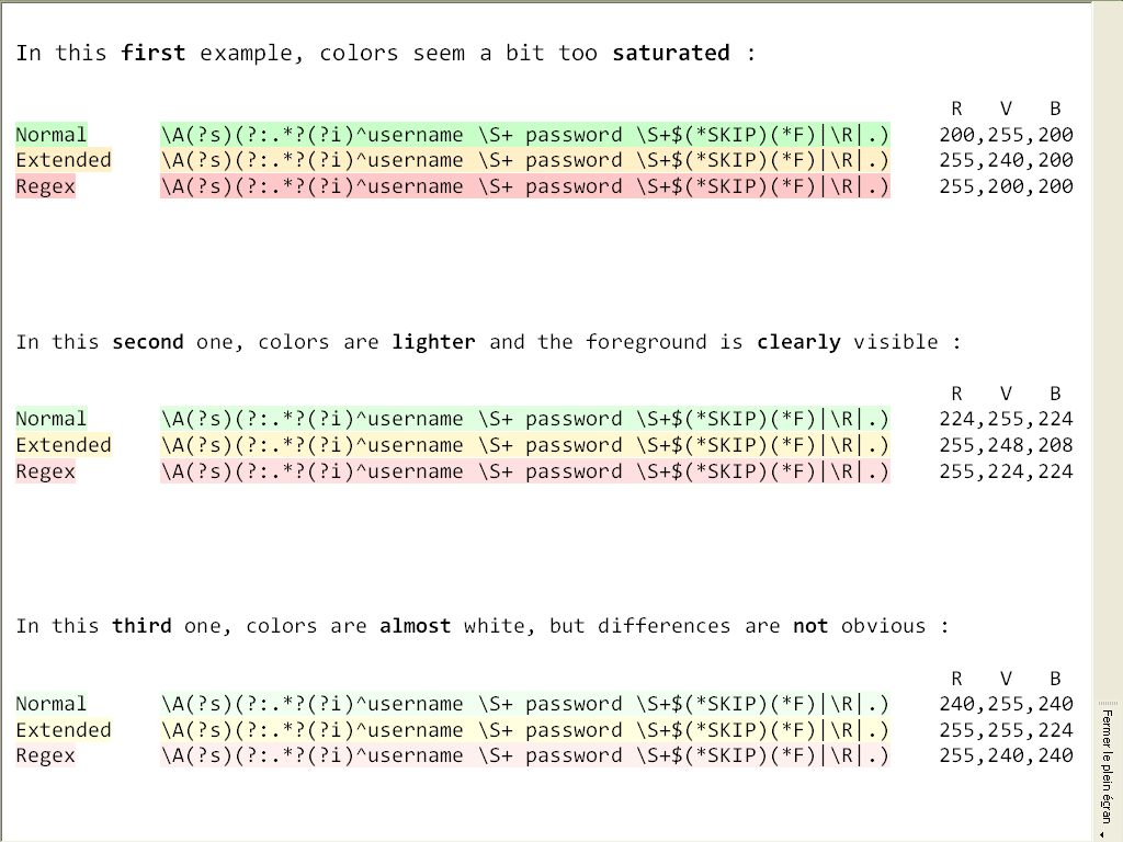

      Hi, all,
      Very often, when making tests and building regular expressions, I’m very surprised and annoyed by the message Find: Can't find the text '..........' … till I realize that current search mode is still set to Normal !

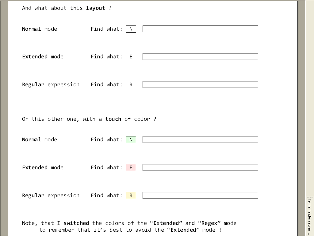

      So I thought about colouring the Find what: zone, as shown in the picture :
      Before submitting this improvement, on GitHub, what is your feeling about this idea ? Personally, I quite like the second solution which seems a good compromise !
      This indication would immediately inform us about the current search mode, for a possible change ;-))

        That said, I would not mind some immediate indicator, like the colors you showed. Though I might suggest that Normal should be white (ie, the way it is now), Extended be one of the yellows you show, and Regex be the green; that way, it would tell us power users “green means you are in the right mode, yellow means you are in a weird mode, and boring white means default”.

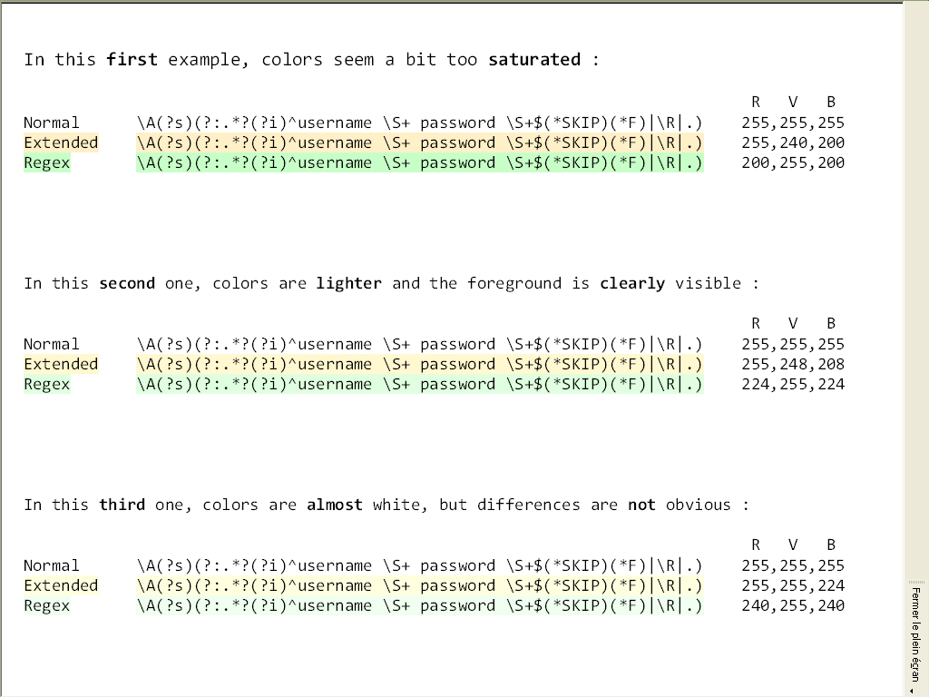

          The Peter’s advices are quite judicious ! Indeed :
          • Less colors are used than with my solution
          • For [ noob ] people, the Normal mode would stay unchanged
          • For people more involved with regexes, the color green is definitively more relaxing than any kind of red, anyway !
          So, I updated my previous picture, as below :

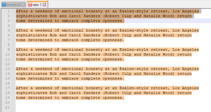

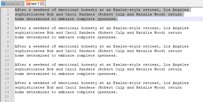

            From this:
            To this at the press of one keycombo:

                Why not use the Search > Mark All feature for that?
                As I’ve just said, above, you must be sure that the current search mode is Normal before running the Mark process !

                A last idea, in the picture below :
                  I think you interpreted that as Search > Mark… instead, despite my orange (not red) coloring in my screenshot. The Mark All commands always work in “normal” mode on literal text; no regexes involved. (I think I remember something about a tie-in to Match case however?)
                  I’m not understanding that picture fully. Does it suggest to move search-mode into a one-letter dropdown, between the Find what text and the box itself? I don’t think that’s what you had in mind, but I kind of like that. :-)
                  If a user didn’t know what those N/E/R were they could hover and a speech callout could explain it.
                  But overall, sorry, no, I for one wouldn’t be on-board with the “colors” idea. But not everyone agrees with everyone else all the time (surely this site has reinforced that idea!).

                        I did not noticed that you spoke about the five Mark Style # ( with style 2 in your picture ). Indeed, I do like this solution, too !
                        I suppose I had forgotten that “styling” is controlled by match-case and match-whole-word settings. I think maybe that makes my suggested solution somewhat less great than I first thought. :-(

                                Second case :
                                • Select again all this text ( 2,109 chars )
                                • Hit Ctrl + C
                                • Cancel the selection
                                • Open the Find dialog
                                • Delete anything in the Find what: zone
                                • Paste the clipboard contents with Ctrl + V, in the Find what: zone
                                • Tick the Wrap around option
                                • Click on the Find Next button
                                => 2,046 characters ▣ are selected ( each char counts for itself, as its code-point is <= U+FFFF )
