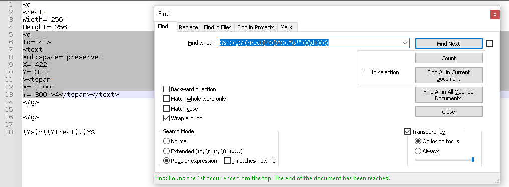

                        @PeterJones sorry to bug you and reopen this again. The regex works awesome, I’ve even tweaked it a little bit. The problem I’m having is it’s catching the beginning g tag with the next g tag. I tried to write an look around exception shown below, but I don’t know where to stick it in the regex written or if there is a better way to exclude the <rect portion.
                        The look around I wrote is:
                        ^((?!rect).)*$
                        This is the problem I’m having in the code.
                        <g
                        <rect
                        Width="256"
                        Height="256"
                        <g
                        Id="4">
                        <text
                        Xml:space="preserve"
                        X="422"
                        Y="311"
                        ><tspan
                        X="1100"
                        Y="300">4</tspan></text>
                        </g>
                        </g>
                        It grabs everything from the first <g tag.
                          PeterJones @Acme1235
                          @Acme1235 said in Regex help with replacement:
                          I don’t know where to stick it in the regex … The look around I wrote is:
                          ^((?!rect).)*$
                          So yes, that sub-expression is trying to find sequences of characters that don’t include rect.
                          Looking at my regex (?s-i)<g[^>]*(>.*\s*">)(\d+)(<), the place I would put it is instead of (or in conjunction with) the [^>]*. It originally said “look for 0 or more non-> characters”. You want to modify that to say “look for 0 or more non-> characters, as long those characters do not include rect”
                          So, let’s merge: the [^>] will take the place of . in your sub-expression (because we don’t want to match >); and then then the sub-expression will take the place of[^>]* in my expression. That combines to (?s-i)<g(?:(?!rect)[^>])*(>.*\s*">)(\d+)(<), which finds
                          (I used the ?: in the outer parentheses to make sure it didn’t change the group# for the matches in your replacement expression – (?:...) is the syntax for non-capturing group)
                          Unfortunately, it’s hard to parse XML in regex (and, in general, a bad idea). But it’s really hard to parse bad/broken XML, like your examples with incomplete tags.
                          A 1 Reply Last reply Reply Quote 0
                          • A
                            Acme1235 @PeterJones
                            @PeterJones awesome thank you so much! Learning regex is a long marathon lol
