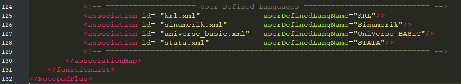

      I then added the following line to the %appdata%\Notepad++\functionList\overrideMap.xml config file:
      <association id= "stata.xml"            userDefinedLangName="STATA"/>
      This then leads to the file %appdata%\Notepad++\functionList\stata.xml, which looks as follows:

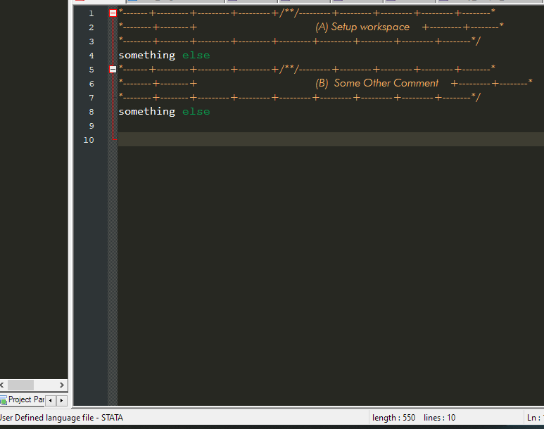

      This simple parser is supposed to find and pin comment blocks like:
      *--------+--------+  	 			(A) Setup workspace    +---------+--------*
      which I use to section my code. What am I doing wrong?

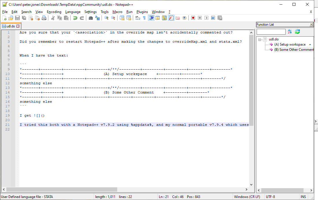

        When I have the text below, and everything set up as you described,
        something else
        *--------+--------+  	 			(B) Some Other Comment    +---------+--------*
        something else

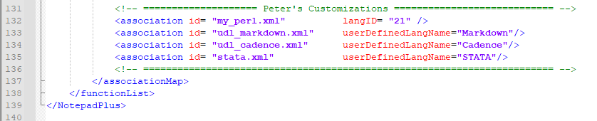

        I tried this both with a Notepad++ v7.9.2 using %appdata%, and my normal portable v7.9.4 which uses the local/portable config directory instead of using %appdata%. Both got the same results. Both worked for me.
        Are you sure that your <association> in the override map isn’t accidentally commented out? It should look something like: 747b0f5f-ac40-445c-9c9b-f25f37352997-image.png
        Did you remember to restart Notepad++ after making the changes to overrideMap.xml and stata.xml? Are you sure your file is being recognized as a STATA file (lower-left of status bar, like in my first example, should indicate the STATA user defined language type)?

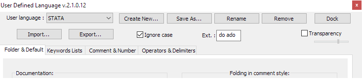

          Thank you very much @PeterJones. I can confirm that I restarted Notepad++ (and my laptop) several times. In addition, my copy of overrideMap.xml looks similar to yours:overridemap.png
          The file is also correctly recognised:

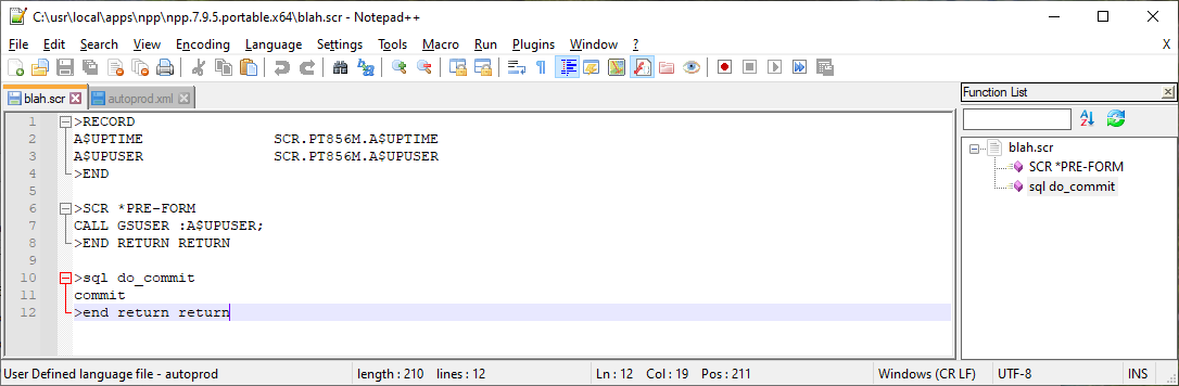

                  Your problem is at least slightly different. When I set a new v7.9.5-64bit unzip up the way you described, Notepad++ didn’t even recognize the “autoprod” User Defined Language. Without that, it’s not going to be able to do Function List based on the autoprod rules.
                  Looking at your UDL definition, it is missing the <Styles>...</Styles> section. I modified your listed file to use the default styles settings:

                  When I restarted the npp 7.9.5, “autoprod” started showing up in my list of UDL. And when I created blah.scr from your sample data file:
                  … ie, it found two of the three “functions”

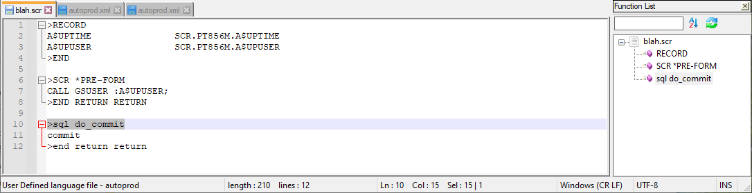

                  Looking at your regexes, I noticed two things:
                  ^>(record\n|RECORD\n)|>(SCR|scr|SQL|sql|start field|START FIELD)[\s]+[\*\w\.\-\_\x24]+[\s|\n]
                  (record\n|RECORD\n)|(SCR|scr|SQL|sql|field|FIELD)[\s]+[\*\w\.\-\_\x24]+[\s|\n]
                  1. The record entry required a single \n. However, if your file uses windows newlines \r\n, that might not work. I replaced all your \n with \R (which, in Notepad++'s regex language means any newline sequence, including \r, \n, or \r\n).
                    ^>(record\R|RECORD\R)|>(SCR|scr|SQL|sql|start field|START FIELD)[\s]+[\*\w\.\-\_\x24]+[\s|\R]
                    (record\R|RECORD\R)|(SCR|scr|SQL|sql|field|FIELD)[\s]+[\*\w\.\-\_\x24]+[\s|\R]
                    After making this change and reloading Notepad++, I now get all three: e0279d23-b0cb-412a-b73f-8c01a197f93d-image.png
                  2. Not as critical, but [\s|\n] (or now, [\s|\R]) might not be doing what you think. Inside of parentheses (), the | means logical-OR, for doing alternatives; inside a character class inside square brackets [], the | is just a literal character. So [\s|\n] matches any space character, the vertical bar, or the newline. Further, \s includes \n, because newlines are spaces to the regex engine. If you don’t want the | to be allowed their, that whole character class can be converted to \s – it doesn’t even need to be in the [\s], because \s already matches any space character (space, tab, newline, and some other weird ones). Similarly, your [\s]+ can be changed to \s+.
