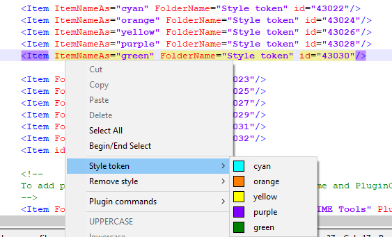

          Unless you’re using an older version, do you really need it to say “blue” or more-accurately, “cyan”?
          Because in Peter’s screenshot, you can actually see the color sample, which is much better than any text.

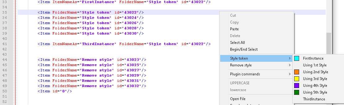

            @Alan-Kilborn said in Changing context menu text in a language.xml:
            Interestingly, if you have more than one instance of that style entry in the contextMenu, only the first instance will have the color box:
            Maybe @Peter-Greistorfer was adding another instance of the style token entry somewhere below the Style token folder (either because of not liking it in a separate folder, or not knowing it already existed in the default contextMenu), and it thus the second copy didn’t have the color box next to it.

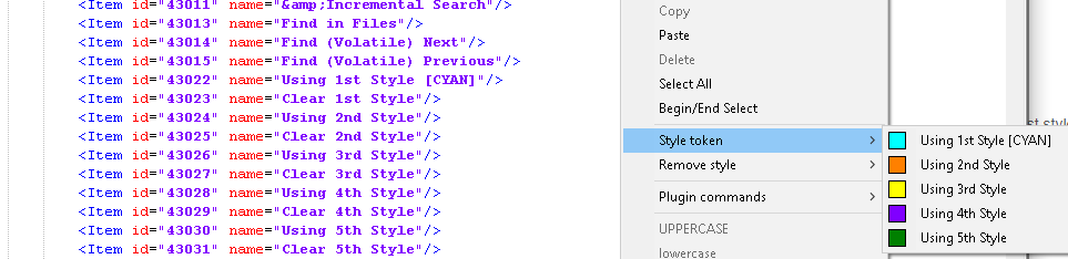

                    what’s the reason I couldn’t edit that “Using 1st style”-entry in the language-files?
                    I don’t know. It works for me (I still had v7.9.2 open, so that’s the version I changed).
                    1. Set Preferences > General > Localization to English (customizable) – this copies english_customizable.xml to nativeLang.xml
                    2. Edit nativeLang.xml, change from
                      <Item id="43022" name="Using 1st Style"/>
                      to
                      <Item id="43022" name="Using 1st Style [CYAN]"/>
                      and save
                    3. Exit Notepad++. Re-run Notepad++
                    4. Right-click context menu: 0211e221-1a8b-422e-85b1-d679b53467c8-image.png
                      (also used that edited name in Search > Mark All)
                    It worked for me.
