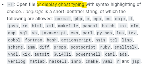

        BTW, the manual page for command line arguments is HERE … but it seems to have a problem, as it talks about “ghost typing” where the -l command line argument is described; this makes little sense…
        Of course, the ghost typing thing is of dubious sense…
