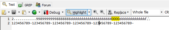

              (RegexBuddy pictured)
              This, in N++ is even handier, but I can’t find where I’ve put it quickly enough sometimes:
              123456789-123456789-123456789-123456789-123456789-123456789-123456789-123456789-123456789-123456789-123456789-
                       10        20        30        40        50        60        70        80        90       100
