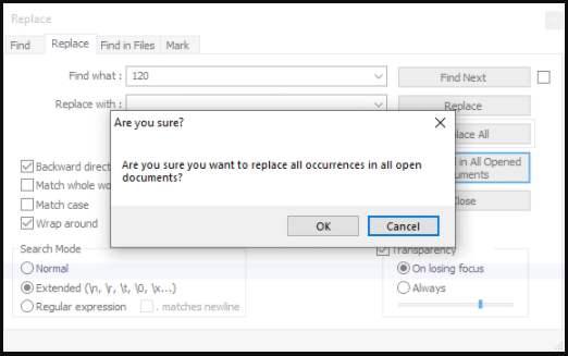

      This has been queried several times but I can’t see where it was definitely answered. all threads seem now to be closed without a definite result being added. There are hints that it is designed as a safety feature and as such can’t/won’t be changed but only “hints”. Same goes for requests to be able to toggle the feature on/off.
      Some say that it’s only one click so it shouldn’t be a bother and I can understand that in low number manually oversighted runs but where you have an automation (automated because it requires hundreds of variants to be examined) that runs into the hundreds that is hundreds of clicks and, for me, despite adding in the use of PTFB to automate the click and altered timings I am finding my Notepad++ automations to now be completely unreliable and prone to mystery breakdowns.
      Was there an on/off toggle inserted somewhere that I’ve missed? Or can that feature be added in the future because those mandatory “are you sure” messages are driving me to distraction.

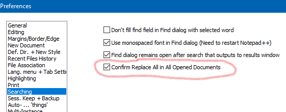

                Yes.
                The solution is to simply untick this box:

                  2. The screenshot that Alan provided is correct: you may see different names for some of the entries in the Preferences dialog (he has customized his significantly), but the “Searching” section is the same name, so you should be able to find it.
                  3. The “Confirm Replace All in All Opened Documents” option has existed since v7.9 in September of last year↗ 🛈, and is documented in the npp-user-manual.org on the Preferences page.
                  If you had started by saying, “When I try to replace all the text in all open documents, it gives me a confirmation message like ![](https://community.notepad-plus-plus.org/assets/uploads/files/1614352976327-ad8aa2f1-df25-4ecd-a1fa-6b2a2351e3f4-image.png). Is there currently a way to disable that prompt? I saw conversations in URL1 and URL2 which talked about it, but there didn’t seem to be an answer there”, you would have gotten a quick and painless answer the first time.
                    @PeterJones said in Deactivate "Are you sure......" dialogue:
                    Oops, yea, sorry, I try not to do that (provide screenshots of my very-customized UI text).
                    But since in this case for the “Searching” subpage, I had not modified the subpage title or any of the entries on that page, it’s OK. (But actually I just didn’t notice what I was doing).
