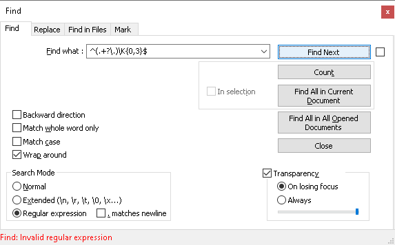

            ^(.+?\.)\K{0,3}$ will not work because {0,3} has nothing to modify – the find dialog will tell you that it was an invalid regex. See the red text at the bottom:
            I believe what was intended was ^(.+?\.)\K\.{0,3}$, which says find one or more of any character (non-greedy), followed by a literal dot; then reset the match, then find 0 to three literal dots. But that still finds the last two dots of the .... This is because the regex is saying you want 0 to 3 dots after the first-found-dot, which is not what the original poster described in text.

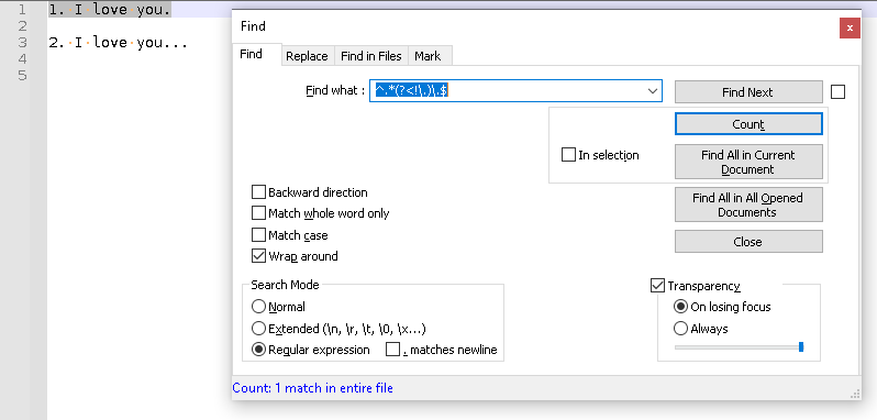

            Put it all together, and you have ^.*(?<!\.)\.$. This finds only one match in your example data:
            This selects the whole line, which I interpreted your description to mean.
            Guy’s solution is a bit different, and took a different interpretation of the description: his finds the 1. as the first match, the I love you. (including the space before the I) as a second match, and the 2. as a third match. So his had 3 matches compared to my 1. This obviously means the original problem statement was unclear, because two reasonable people came up with two very different interpretations of the requirements.
