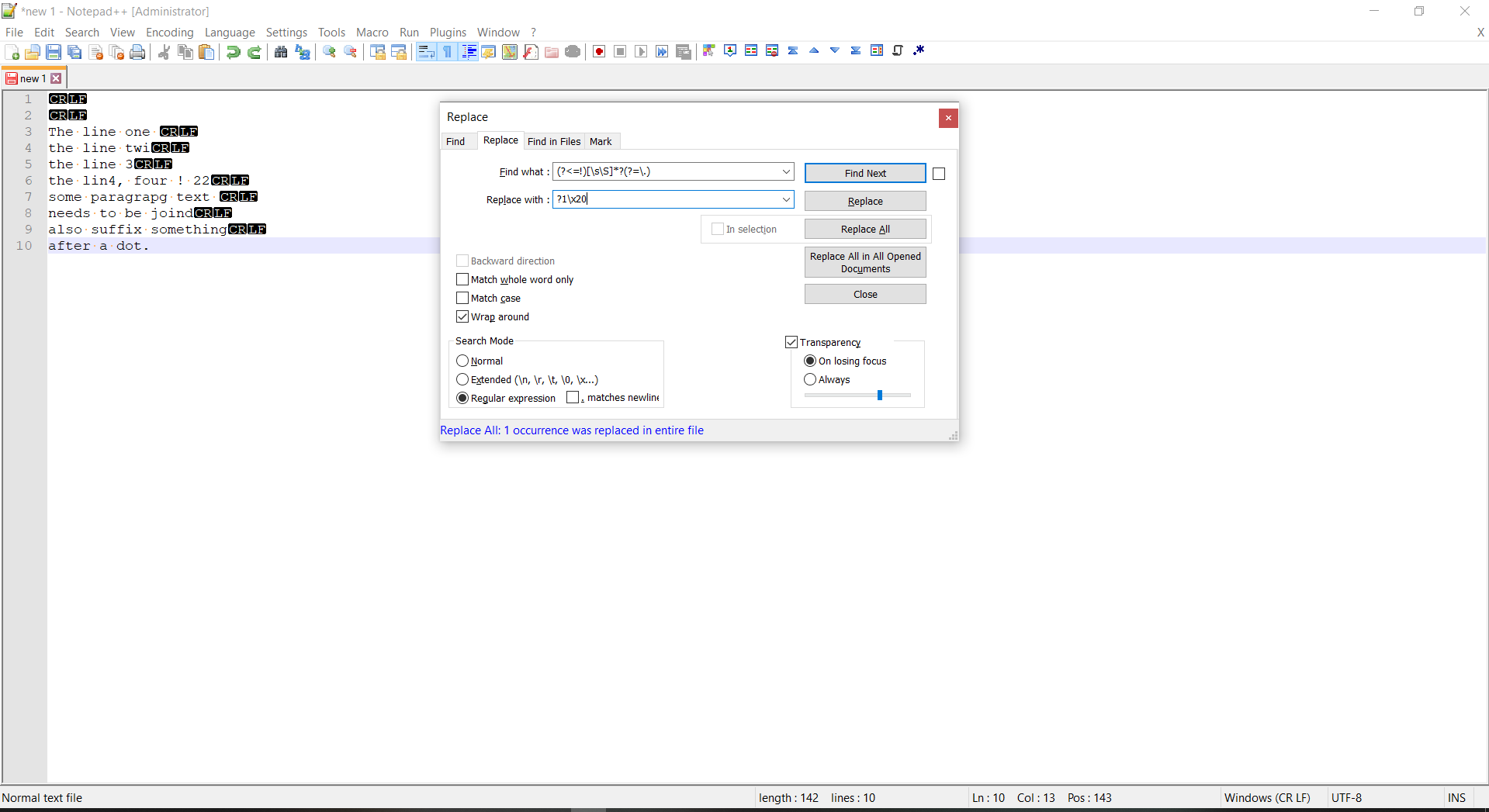

                @PeterJones Sir, I have tried to merge the lines. Find regex
                (?<=!)[\s\S]*?(?=\.)
                Matches the lines . But when merging (line joining) Using Replace function
                ?1\x20
                it removes all the lines completely. Please look in to that. I need to join the Lines. Notepad++ regex.png .
                  PeterJones @Ohm Dios
                  @Ohm-Dios ,
                  The problem: You have no group1 in your FIND. But your replace uses the conditional, so it says “if group1 matches, replace with the space character”. There is no group one, so the conditional is false, so it gets replaced with nothing.
                  If you put parentheses around the stuff between the ! and ., then that will put it into group1.
                  You also had a restriction in your original text (where you wanted a join-equivalent regex “applied between ! (\d+) and .”), but the example regex didn’t include that requirement, so I think you haven’t fully understood what you’re trying to use.
                  But the logic of your FIND won’t help you find the newlines and replace them with spaces, because there’s nothing in your regex that talks about newline sequences, so you’ve got a more fundamental problem than either the group1 or the lack of the check for the digits after the !.
                  Trying to find and replace all the newlines between a start marker and an end marker sounds like one of Guy’s generic regexes that he’s shared, but I’m not an expert at finding and applying those. For now, maybe @guy038 could point you to the post with the right generic pattern to use for that. (With a lot of effort, I could hack something together, but it wouldn’t cover all the conditions that Guy’s generic ones would get right)
