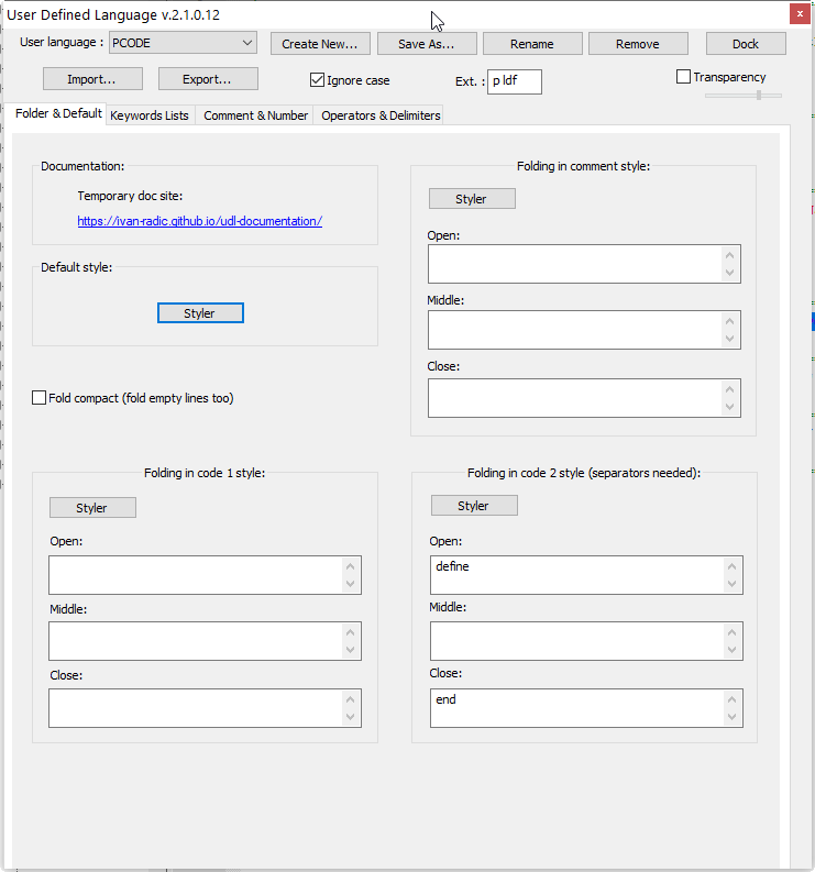

          I am using UDL, these languages have the extensions configured etc.
          However, I took the parser and put it in like it used to be, changed the id etc…
          for instance:
          <parser
          				displayName="p"
          				id         ="pcode.xml"
          				commentExpr="(?m-s:;.*$)"
          				<function
          					mainExpr="^DEFINE\s+\K\w+"
          			</parser>
          I changed the overridemap.xml to contain the following, still no love.
          <association id=    "pcode.xml"      userDefinedLangName="PCODE" />
          Language definition:
          Any tips…???
