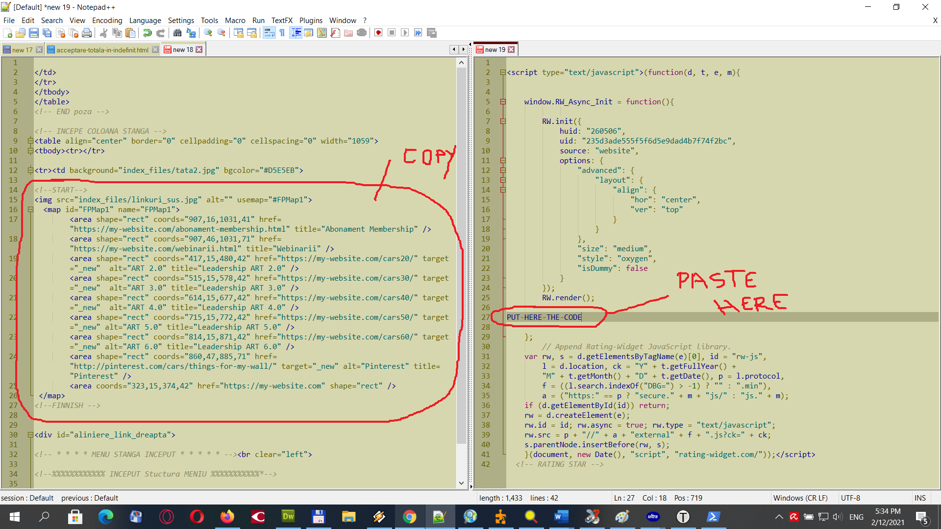

      hello, the image will explain what I want to do. I have a lot of html files in Folder-1 and the same number of files in Folder-2. The name of the files is the same on both folders, only the content of them is different. As you can see in this image what I want to do is to copy the lines from <!–START–> to <!–FINNISH --> and paste them to other files from second folder, in html files, in the point PUT-HERE-THE-CODE
      You have to know that the content of <!–START–> to <!–FINNISH --> is different on all pages, so only this 2 words are repeated in all files, the links are different. And in the Folder-2, the only part that repeats in all files is PUT-HERE-THE-CODE
      SOLUTION. I made a regex for this task: This will select the lines between <!--START--> to <!--FINNISH -->
      FIND: (?s)(<\!--START-->).*(<\!--FINNISH -->)
      But how can I move this content in other files, from Folder-1 to Folder-2 to other file over the word PUT-HERE-THE-CODE ?

          to make an idea, should be something like:
          FIND: (?s)(START).*(FINNISH) \ Folder-1
          Replace on: $1 PUT-HERE-THE-CODE $2 \ Folder-2
          Is it possible with notepad++ ?

              yes, all files from Folder-1 have the same block <!–START–> •••••• <!–FINNISH --> but with different content. And all files from Folder-2 have the same word/line PUT-HERE-THE-CODE

                  I don’t know if it can be done just with regex and notepad++. Maybe in the future. I know that in Sublime-Text this task can be done with a plugin made in Python.
                  But, instead, you can use very easy PowerShell for this task.
                  This solution is very simple. Just copy this code in PowerShell from Windows10
                  $sourceFiles = Get-ChildItem 'c:\Folder1'
                  $destinationFolder = 'c:\Folder2'
                  foreach ($file in $sourceFiles) {
                  $sourceContent = Get-Content $file.FullName -Raw
                  $contentToInsert = [regex]::match($sourceContent,"(?ms)<!--START-->(.+)<!--FINNISH -->").value
                  $destinationContent = Get-Content $destinationFolder\$($file.Name) -Raw
                  $destinationContent = $destinationContent -replace 'PUT-HERE-THE-CODE',$contentToInsert
                  Set-Content -Path $destinationFolder\$($file.Name) -Value $destinationContent -Encoding UTF8
                  } #end foreach file
                    Alan Kilborn @Vasile Caraus
                    @Vasile-Caraus
                    A viable technique, although not a technique inside Notepad++.
                    I think your technique is going to also copy over the “START” and “FINNISH” lines into the destination file, which, to the OP, may not be desirable.
