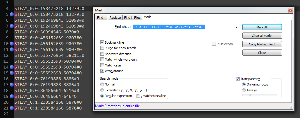

      astrosofista @Alan Kilborn
      If instead of highlighting duplicates, bookmarking them is good enough, then I have something for you:
      Mark: (?-s)([^ ]+?)( .*\R)\K.(?=\1 .*\R)+
      On the downside, it will highligth the first char of a duplicate line, as follows:
      Cheers

              Using the Mark feature allows you to bookmark one or several subset(s) of lines, which are easy to copy/cut and paste elsewhere or to delete !
              Once you finished to delete some subsets of your file, it will probably remain some lines, with this temporary virtual key ! To get rid of it, it’s elementary, use the regex S/R :
              SEARCH ^.+\t
              REPLACE Leave EMPTY
              P.S. : I just realize that, if you use the Search > Bookmark > Inverse Bookmark option, some the generic regexes are not essential !

                  • guy038G Offline
                    Hello, @cadaver182, @alan-kilborn and All,
                    In the particular case where the key is, simply, all the line contents, the Key Regex is just .+ and the five regexes, from regex A to regex E, can be, finally, simplified as below :
                    • (A) (?-s)^(.+)\R(?=\1\R)    Mark all the duplicate lines, except for the last one
                    • (B) (?-s)^(.+)\R(?=\1\R)(*SKIP)(*F)|^.+\R    Mark unique lines and 1 duplicate ( the last sorted )
                    • (C) (?-s)^(.+)\R(?:\1\R)*\K\1\R    Mark 1 duplicate line, only ( the last sorted )
                    • (D) (?-s)^(.+)\R(?:\1\R)+    Mark all the duplicate lines
                    • (E) (?-s)^(.+)\R(?:\1\R)+(*SKIP)(*F)|^.+\R    Mark all the unique lines
                    IMPORTANT :
                    • These 5 regexes must be performed against a previously sorted list !
                    • That list must also end with a pure blank line
                    Best regards,
