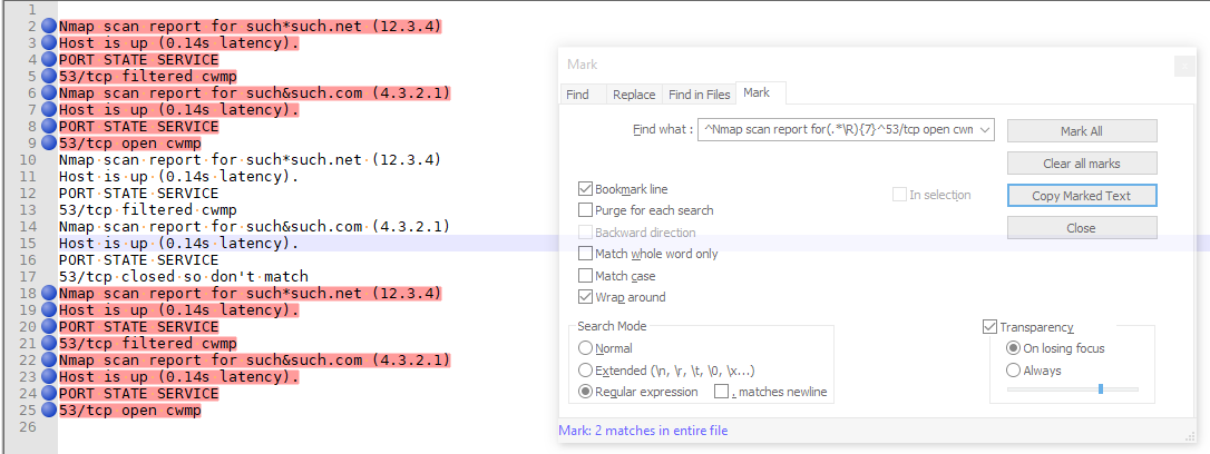

        Example Data (using the formatting hint from above, also mentioned in the footnote at the bottom):
        Nmap scan report for such*such.net (12.3.4)
        Host is up (0.14s latency).
        PORT STATE SERVICE
        53/tcp filtered cwmp
        Nmap scan report for such&such.com (4.3.2.1)
        PORT STATE SERVICE
        53/tcp open cwmp
        PORT STATE SERVICE
        PORT STATE SERVICE
        53/tcp closed so don't match
        PORT STATE SERVICE
        PORT STATE SERVICE
        53/tcp open cwmp
        In this example, I believe you want the first 8 lines and the last 8 lines to match, but not the center 8 lines.
        For me, it does match:
        If this isn’t sufficient for you, please follow the advice below and clarify.
