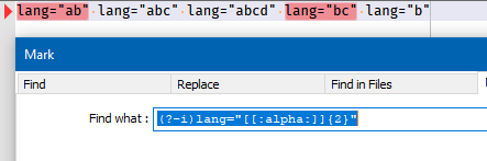

    find two letters between quotes in lang tag
    14 Posts 4 Posters 3.8k Views
      Alan Kilborn @Pouemes44
      @Pouemes44 said in find two letters between quotes in lang tag:
      Alan it took tag with 3 letters
      Hmmm. Really not sure how you could get that result, reference:
      Even though you didn’t have luck with mine, here’s how I’d change mine to exclude matching fr :
      (?-i)lang="(?!fr)[[:alpha:]]{2}"
      • Pouemes44P
        Pouemes44
        thanks Alan yes work like this
        perhaps firt time i forget the last quote, that why it was not correct
        a great thanks

                  @pouemes44, the last regex, of my previous post, finds any language code, of 2 or 3 lowercase letters, optionnally followed with a dash and a country code of two uppercase letters, different from, either, "fr" and "fr-FR" OR finds the specific zh-Hans and zh-Hant Chinese syntaxes
                  Now, if we assume, as a matter of principle, that the language codes are all correct, in your files, the search of these language codes are more simple ! Indeed, as no control about syntax is needed, this regex, below, should be enough ( The two language codes "fr" and "fr-FR" are not taken in account ! )
                  SEARCH / MARK (?-is)(?<=\x20lang=")(?!fr"|fr-FR").+?(?=">?)
                  And, as @alan-kilborn said, if you prefer to highlight the entire lines, with their EOL chars, containing a language code, use that regex :
                  MARK (?-is)^.*\x20lang="(?!fr"|fr-FR").+\R?
                  Which looks for entire lines, EOL included, containing, at least, a space char, followed by a string lang", with this case, and followed with a valid language code, different from, either, "fr" and "fr-FR"
                  Finally, if you just need to bookmark the lines containing a global HTML attribute lang"..........", containing a valid language code, different from, either, "fr" and "fr-FR", use this final regex :
                  MARK (?-i)\x20lang="(?!fr"|fr-FR")
