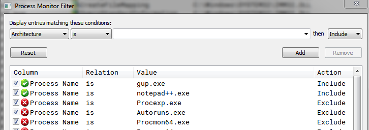

                do you know procmon?
                Just before you click install I would start it, set a filter for process to be notepad++.exe and gup.exe
                and see what it does
                Maybe that will give you a hint why this isn’t working for you.
