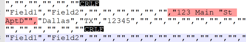

      For instance, given this sample, that you’ll copy in a new tab :
      "0","0","","","","","","","","","","","","",""
      "Field1","Field2","Field3","Field4","Field5","Field6","Field7","Field8","123 Main "St AptD"","","Dallas","TX","12345","","","","","","","","","","","","","","","","","","","","","","",""
      "Field1","Field2","Field3","Field4","Field5","Field6","Field7","Field8","This fie"ld is NOT correct","","Dallas","TX","12345","","","","","","","","","","","","","","","","","","","","","","",""
      ," abcde","","ijk   "123"," 987 "This is"a small""pie"""ce of"text for"  tests" !!","","abc"de"fgh"ij","12345"
      1234567890","","","","",""
      • Paste the above regex in the Find what: zone
      • Preferably, tick the Purge for each search option
      • Possibly, tick the Wrap around option
      => All the fields ,........, containing an even number of " ( thus any correct field ), are marked in red style. This means that any zone, still unmarked, contains an odd number of double quotes, probably indicating one " character, too many or too few ;-))
      Note that, for a correct scanning process of the text, the regex marks from the comma, before each zone "....." till the ", right before the next comma !
      You may, as well, use the Find dialog to visualize each correct field, one a a time !

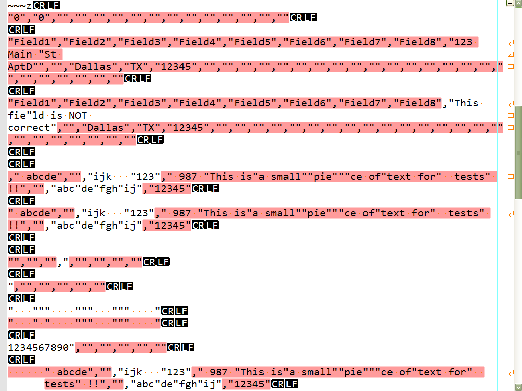

      Here is a snapshot of the sample, after the mark operation :
      As you can see, all the fields non marked are incorrect in some ways and need examination.

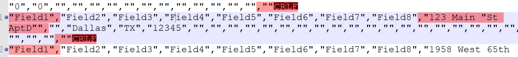

        Hi, @texaskcfan, @Peterjones, @terry-r and All,
        @guy038 said :
        Note, also, that it’s impossible build up a regex in order to get the opposite logic, i.e. which would match the general case of any zone, between two commas, containing an odd number of double quotes inside !
        Well… I was wrong :-( As usual , just when I woke up, I understood the way to do ! We simply must add the two control verbs sequence (*SKIP)(*F) at the end of the previous regex and add an alternative which selects all standard chars sequence till the nearest comma , character ;-)), giving the final regex :
        MARK (?x) (?:^\h*|,) (?: ( " (?: [^"\r\n,]++ | (?1) )* " ) )+? (?=,|\R|\z) (*SKIP) (*F) | (?-s) .+? (?=,|\R|\z)

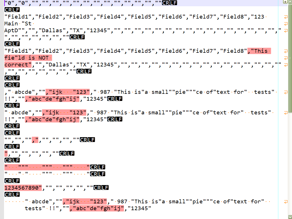

        With the same sample as in my previous post, we get, this time :
        Now, it’s even more easy to focus our attention on the problem areas !

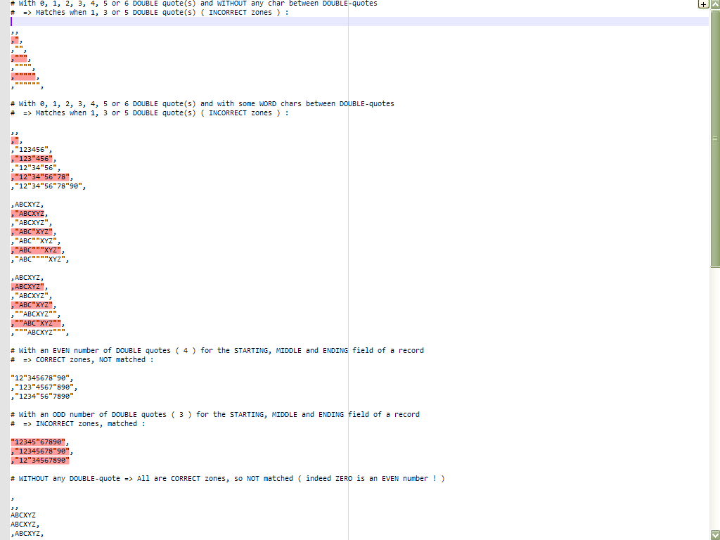

            I improved my regex in order to satisfy all the possible cases and get a coherent behavior :
            MARK (?x) (?:^\h*|,) (?: ( " (?: [^"\r\n,]++ | (?1) )* " ) )+? (?=,|\R|\z) (*SKIP) (*F) | (?:^\h*|,) (?: [^"\r\n]+ (?=,|\R|\z) (*SKIP) (*F) | [^,\r\n]+? (?=,|\R|\z) )
            So, to summarize, this regex will mark, from beginning of line, any possible comma and its next zone, till the nearest comma, excluded, or till the end of line / file, ONLY IF  this zone contains an odd number of double quotes "
            Just use this sample, below, to test the regex against !
            # With 0, 1, 2, 3, 4, 5 or 6 DOUBLE quote(s) and WITHOUT any char between DOUBLE-quotes
            #  => Matches when 1, 3 or 5 DOUBLE quote(s) ( INCORRECT zones ) :
            # With 0, 1, 2, 3, 4, 5 or 6 DOUBLE quote(s) and with some WORD chars between DOUBLE-quotes
            ,"123456",
            ,"123"456",
            ,"12"34"56",
            ,"12"34"56"78",
            ,"12"34"56"78"90",
            ,ABCXYZ,
            ,"ABCXYZ,
            ,"ABCXYZ",
            ,"ABC"XYZ",
            ,"ABC""XYZ",
            ,"ABC"""XYZ",
            ,"ABC""""XYZ",
            ,ABCXYZ,
            ,ABCXYZ",
            ,"ABCXYZ",
            ,"ABC"XYZ",
            ,""ABCXYZ"",
            ,""ABC"XYZ"",
            ,"""ABCXYZ""",
            # With an EVEN number of DOUBLE quotes ( 4 ) for the STARTING, MIDDLE and ENDING field of a record
            #  => CORRECT zones, NOT matched :
            "12"345678"90",
            ,"123"4567"890",
            ,"1234"56"7890"
            # With an ODD number of DOUBLE quotes ( 3 ) for the STARTING, MIDDLE and ENDING field of a record
            #  => INCORRECT zones, matched :
            "12345"67890",
            ,"12345678"90",
            ,"12"34567890"
            # WITHOUT any DOUBLE-quote => All are CORRECT zones, so NOT matched ( indeed ZERO is an EVEN number ! )
            ABCXYZ
            ABCXYZ,
            ,ABCXYZ,
            ,ABCXYZ
            And we get the picture :

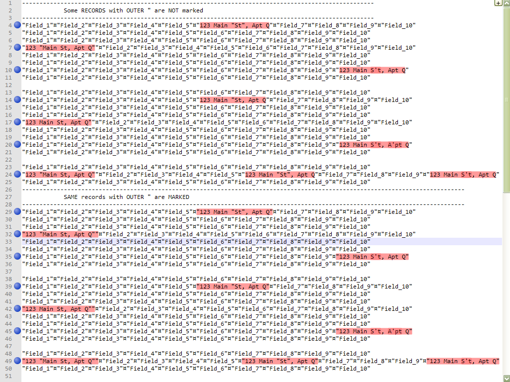

                      Hello, @texaskcfan, @peterjones, @terry-r and All,
                      While searching a solution, I realized that the comma delimiter can also be found inside fields themselves ! This is really problematic :(
                      So, in order to get a neat field delimiter, we should, temporarily, change the , delimeter by, let’s say, the ¤ character if this char is not used in your file ! From now on, I suppose that it’s the case :
                      Thus, we first change the field delimiter of your file with the simple normal S/R :
                      SEARCH ","
                      REPLACE "¤"
                      Note that you may replace the ¤ char with any char not used yet !
                      And, at the very end of the process, you’ll just perform this normal S/R to get the right syntax, again :
                      SEARCH ¤
                      REPLACE ,
                      Now, given your 3 error cases that you provided, here is my first try towards a complete solution ! I’m using the free-spacing mode (?x) for a better readability !
                      • MARK (?x) (?:^"|"¤") \K ([^"'¤\r\n]*?) ("|') (?1) \2? (?1) (?="¤"|"\R|"\z)    without the outer " chars marked
                      OR
                      • MARK (?x) (?:^|"¤) \K " ([^"'¤\r\n]*?) ("|') (?1) \2? (?1) " (?=¤"|\R|\z)    with the outer " chars marked
                      If we try these two regexes, against this sample text, below :
                      "Field_1"¤"Field_2"¤"Field_3"¤"Field_4"¤"Field_5"¤"123 Main "St", Apt Q"¤"Field_7"¤"Field_8"¤"Field_9"¤"Field_10"
                      "Field_1"¤"Field_2"¤"Field_3"¤"Field_4"¤"Field_5"¤"Field_6"¤"Field_7"¤"Field_8"¤"Field_9"¤"Field_10"
                      "123 "Main St, Apt Q""¤"Field_2"¤"Field_3"¤"Field_4"¤"Field_5"¤"Field_6"¤"Field_7"¤"Field_8"¤"Field_9"¤"Field_10"
                      "Field_1"¤"Field_2"¤"Field_3"¤"Field_4"¤"Field_5"¤"Field_6"¤"Field_7"¤"Field_8"¤"Field_9"¤"123 Main S't, Apt Q"
                      "Field_1"¤"Field_2"¤"Field_3"¤"Field_4"¤"Field_5"¤"123 Main "St, Apt Q"¤"Field_7"¤"Field_8"¤"Field_9"¤"Field_10"
                      "123 Main St, Apt Q""¤"Field_2"¤"Field_3"¤"Field_4"¤"Field_5"¤"Field_6"¤"Field_7"¤"Field_8"¤"Field_9"¤"Field_10"
                      "Field_1"¤"Field_2"¤"Field_3"¤"Field_4"¤"Field_5"¤"Field_6"¤"Field_7"¤"Field_8"¤"Field_9"¤"123 Main S't, A'pt Q"
                      "123 "Main St, Apt Q""¤"Field_2"¤"Field_3"¤"Field_4"¤"Field_5"¤"123 Main "St", Apt Q"¤"Field_7"¤"Field_8"¤"Field_9"¤"123 Main S't, Apt Q"
                      we get :
                      • In that sample, I simply consider lines of 10 fields
                      • In lines 4, 7 and 10, you’ll recognize your 3 error cases
                      • In lines 14, 17 and 20, I deleted one double quote and added one single quote, which are also correctly detected as a possible error by the regex. But, If you do not need the detection of these extra cases, I won’t have any problem to modify the regex
                      • In line 24, I added a record with the 3 error cases, together
                      • From lines 29 to 50, results are identical to those above, but the outer double-quotes, containing fields, are also marked !
                      In this text, it’s very easy to move from one error’s zone to an other one :
                      • Use the F2 and the Shift + F2 shortcuts to move from one erroneous record to the next or previous one
                      • Use the Ctrl + 0 and Ctrl + Shift + 0 shortcuts, on the main keyboard, to move from one erroneous field to the next or previous one
                      You’ll remark, that I haven’t spoken yet, about a method to isolate all the erroneous fields, one per line. Indeed, @texaskcfan, I would like, first, to get your feeling about keeping records as they are ( excepted for the temporary field delimiter change ! ) and simply navigating between all error’s zones, with the shortcuts mentioned above !
