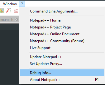

            Please, provide more info on Notepad++ version and your OS.
            Also, you can try creating an issue here if it’s still a problem in the current version of Notepad++.

              Notepad++ v7.5.9 (64-bit)
              Build time : Oct 14 2018 - 15:19:55
              OS : Windows 10 (64-bit)
              Plugins : DSpellCheck.dll mimeTools.dll NppConverter.dll
              The current version (7.9.2 , 7.9.1 , 7.9 etc ) does not give any warning and crashes when you encounter a large file during the search.
              i can handle using 7.5.9 version, there is no problem in this version right now.
