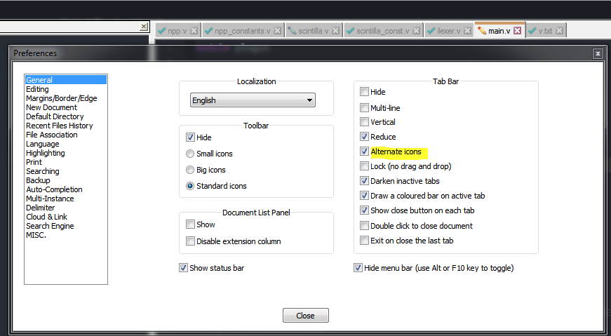

        Ekopalypse @Kara Kitai
        @Kara-Kitai said in Newbie here, a few quick questions!:
        he unsaved tab is specified by use of asterisk(*)
        You use the npp in a way it is not intended to be used.
        Besides being used as a general purpose text editor, its main function is to be used as a lightweight programming editor.
        Which version of npp are you using?
        Is there a menu ? available in your version and within this menu an item debug-info? If yes, can you paste what you find there?
        With my version 7.9.2 I can change the icons.

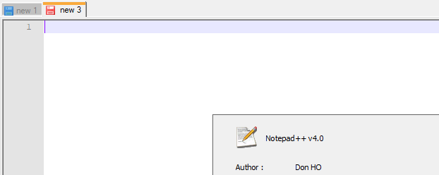

                      @Kara-Kitai ,
                      Back to question #1: without changing the setting that @Ekopalypse mentioned, the unedited vs edited tabs look like:
                      The scratchpad on the left is unedited and not active, so is a shaded blue; the “new 1” is edited and inactive, so is a shaded red. The active tab will be either blue or red as well.
                      With the “Alternate Icons” checkbox that @Ekopalypse pointed out, it uses a checkmark for saved, and a pencil for edited, which makes it easier to see on the inactive tabs and for people who have difficulty noticing color differences:
                      … which, IMHO, is much better than the asterisk from akelpad.
