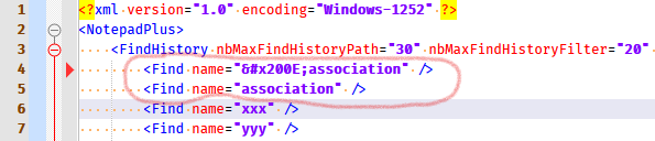

      Normally, if you try to search for something you’ve searched for before, the find history will only contain the entry once; but I was seeing:
      Note that “association” appears twice!
      I was finding (pun!), that depending upon which “association” I would choose, I’d get differing results for a Find All in Current Document search:
      So…I stopped what task I was involved in, to figure this thing out.
      I exited N++ (to get it to save the find-history), restarted, and then examined config.xml and therein lay the truth:
      Copying the “strange” one out of config.xml and pasting into a new N++ tab, I saw:
      But I only saw this because I have a script which sets “invisible” UTF8 characters to be visible with a “representation”.
      So, yes I can now see why some of my searches failed.

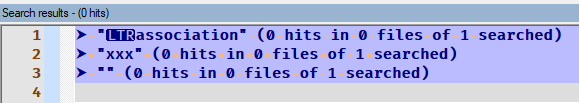

              Ah ha! Success:
              Now someone will ask me how I did that. :-(

                  But the kicker here is I’m (now) wanting to do it (and, lately, actually doing it) in the “Search result” window. Which, in Pythonscript, isn’t merely as simple as calling editor.setRepresentation().
                  I suppose the onus is now on me to show how I’m doing it, since I started this… :-) I’ll put something together…
                  EDIT: BTW, when I said:
                  “Search result” window doesn’t have a “direct” way either.
                  I should have said “pun (again) intended” because it involves using something called SciLexer.Scintilla_DirectFunction
                  Again, more later when I have time to put something (concise) together.

                    Right. It might be hard (well, harder than what I ended up doing) to show something like this in the Find what box of the Find window.
                    Why? Well, that box is pure Windows, not Scintilla, so I’m not even sure what “special, invisible” characters would appear like there. I’m fairly certain that each time a Ctrl+f pulls selected characters from a Scintilla window to populate the Find what control with, it undergoes a UTF8 (or whatever Scintilla/N++ encoding is actively set)-to-Windows-mbcs conversion (probably don’t have the exact terminology right here, but the gist is that I mean “whatever encoding Windows uses internally”).
                    Bottom line, I’m happy with just the search-sanity check that seeing these characters in the “Search results” windows gives me. No more troubles of this nature for me!
                    note 1: by “mbcs” I meant “multibyte-character-set”
                    note 2: when I said I’m not even sure what “special, invisible” characters would appear like there, actually if I select just the LTR character and press Ctrl+f, I see “nothing”, except, no, my caret in the Find what control is now different than usual, it glimmers with a rainbow like effect…so this is helpful in one way, but not totally helpful.
